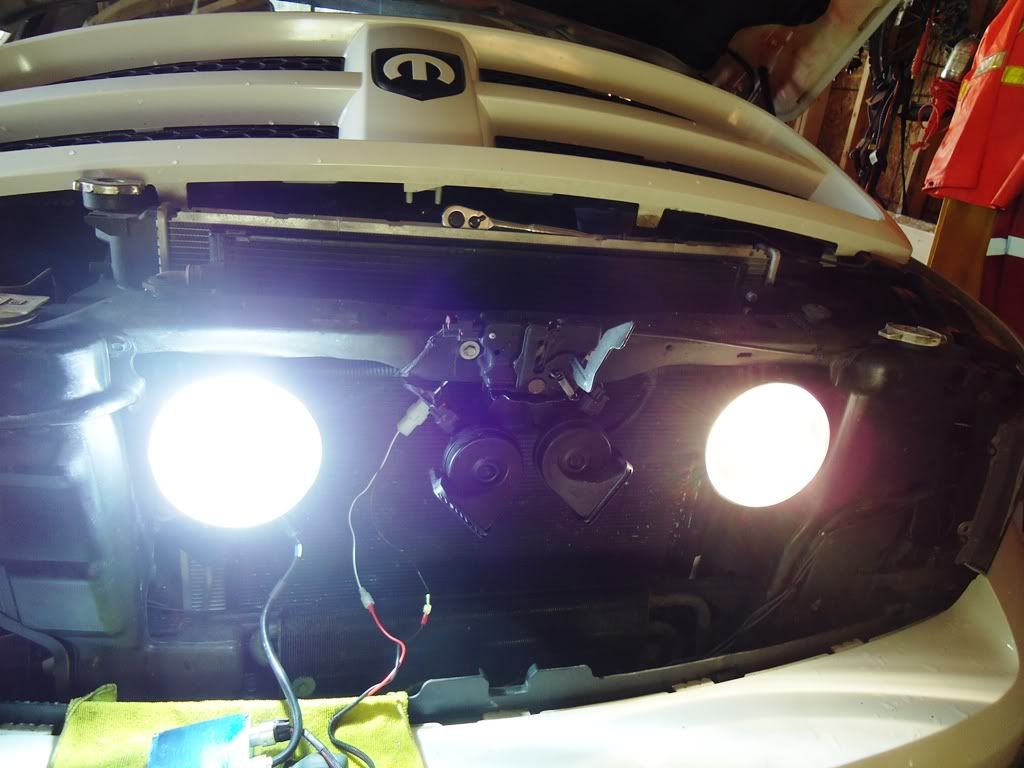

    There just a set of 6" PIAA 520s (halogen), They were bright, but could be better(behind the grill kills some of the light of course). So I spent 60$ from ddm, modded them to accept the HID harness and thats what I got. These things are AMAZING now.
    Just send me a message anytime man, always glad to help

    There is actually an upper crossmember that runs the length of the grill. There are two little holes you can acess in the top of the crossmember. All you have to do is drill a hole threw the bottom layer of steel and wala.
    Its pretty simple, once you have your grill ripped off and what not you can tell what I am talking about. They are the perfect location too.
    Sorry, its just hard to explain you'd have to see it yourself. Just rip your rad cover off and grill, youll see
