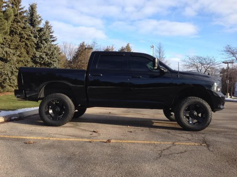

I had my truck at 3 different stages of lift and hope this can help others with their decision
6" RCX, 2.1 Bilstiens,
1" TGC Rear Coil Spacer,
37" Nitto Trails (20x9, 0 offset)
6" RCX, 2.1 Bilsteins,
3" PA Body Lift
6" RCX, 1.4 Bilstiens,
325/60/20 Nitto Terra (20x10, -24 offset)
Top pic in this post...

Thanks bud
