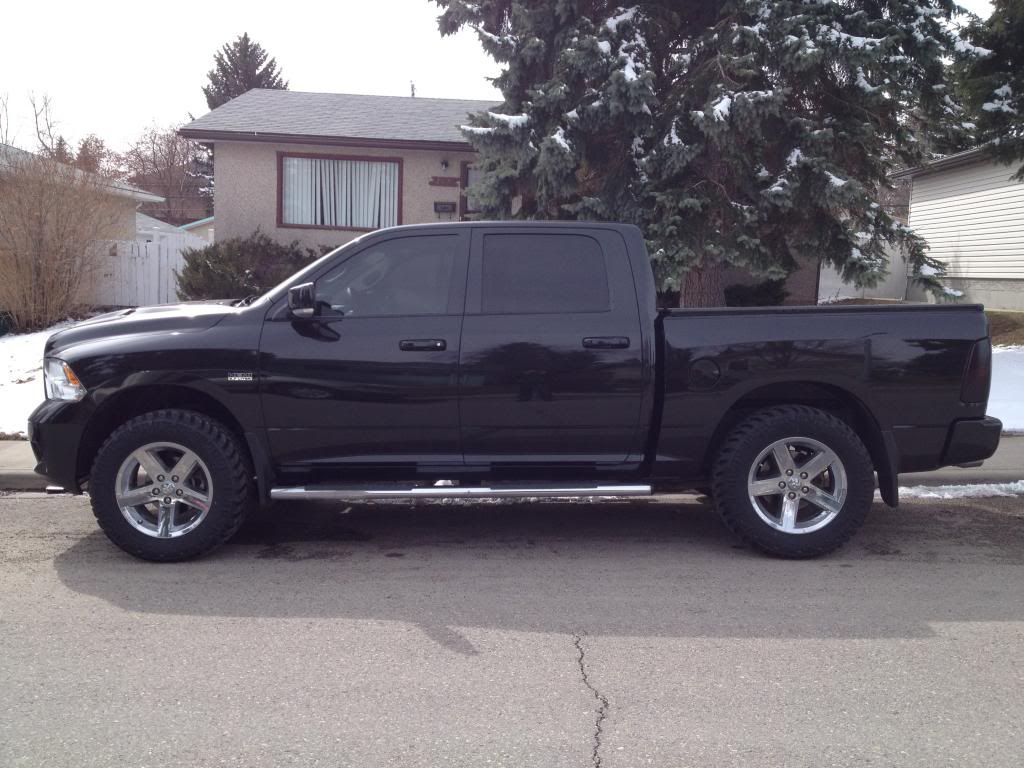

Any one running bilstiens at max on an 06-08 with 35's, 12.5 wide, and how much offset on the rims.. Looking for the tire to stick out around 1.5inch past the body.
Or if someone could direct me to a post.. So many pages of awesomeness.
I believe gonefishin is running this.
He has a 20x9 -12 offset.
because the Bilsteins on a 3rd gen is only 2.1" the offset of the rim will play a HUGE factor in fitting 35's
20x9, 0 offset is the most ideal
Do you think it is possible with a 17 inch rim with 0 or -12 offset?
Edit.. Just looked at gonefishin's set up.. and he is running 17's.. So I will just simply ask him if he gets any rubbing at all.
Thanks a lot Fast
NP!
He actually has a 17x8.5 and I think a -12 offset
But he would be your best bet for knowledge

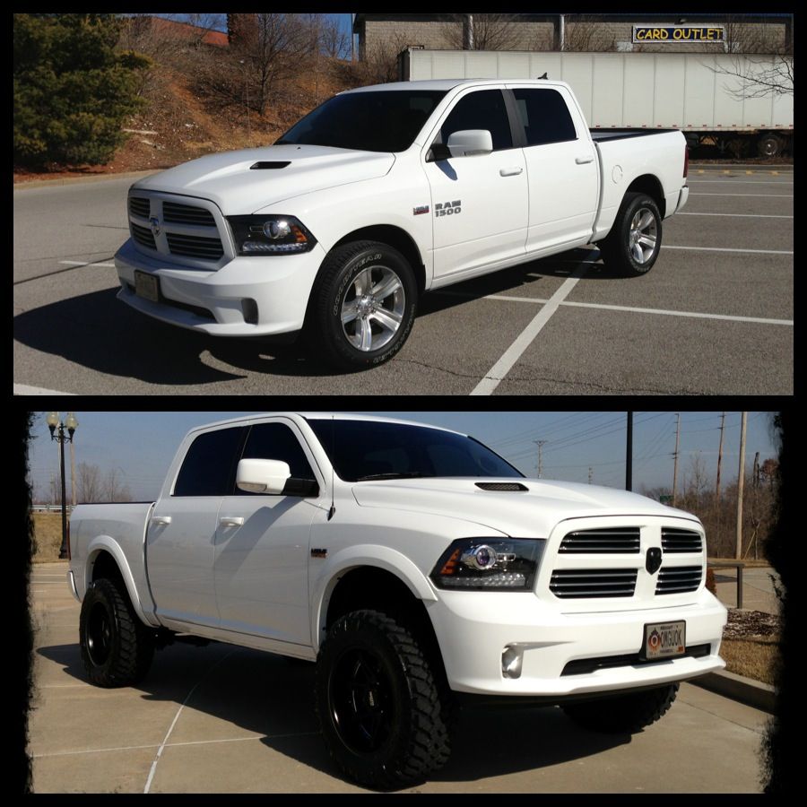

Originally Posted by sporty11 View Post
[/URL]
Also want to give a shout out to Andrew aka FastNugly for all the help and great prices!! Cheers!
What level of window tint do you have?
I am always shocked at how our truck doesn't look that big when the picture is taken by itself, but when it is next to another truck it really shows how big it really is.
