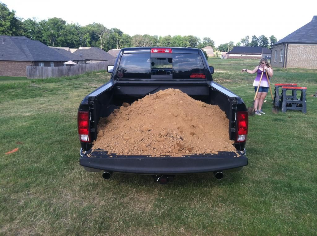

I had 2 yards of wet sand in it with the bags a 35psi and it sagged all the way to the bump stops, But i think i exceeded the capacity of the truck and the air bags.
2 yards??? are you sure about that? 1 yard of sand can easily weigh 2500 lbs. Your'e lucky you didnt break something.
I stand corrected it wasnt even sand but a load of fill dirt for my pool. Not sure how much but look for your self pretty darn heavy, dont think i will do that again.
Wow, that's squatting pretty good, all I can say is good on ya' for using your truck as a truck! Your hood stripes look absolutely killer!
