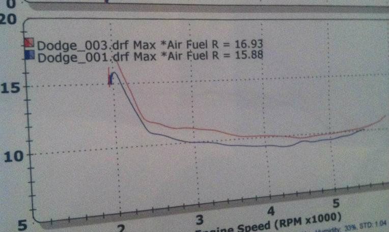

Originally Posted by CHVYKLR View Post
16 to 1 a/f?? that's a typo right because that's dangerously lean
Yes, its the wrong number I just pulled the list of max numbers off the dyno sheet. its actualy running right about 10:1

I was going to say 16 seemed a bit off I know the HEMI's are happy around 12:1
yeah mine is tuned to 10:1 also and I'm hoping to get it adjusted to 11:1.
the build looks awesome. the 3.4 whipple is a beast. I've seen some 4.6 and 5.4 builds that make crazy power with that blower.
