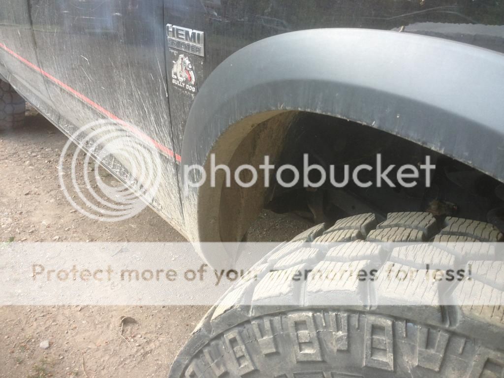

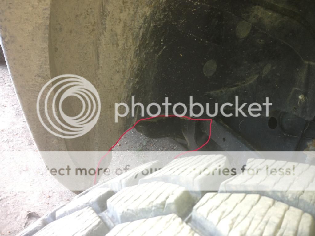

The red line shows the plastic on the rear of the inner fender that I trimmed , the wheels also have an extra 2" of backspace , the tires measure 12.1" wide X 36.2" tall in this pic
Yes she's dirty , this truck gets used and abused

Thank you Sled.. I was wondering what you had done :P .. I don't get rubbing... but IF I stress the wheel to far I hit my mudflaps .. but its rare..
