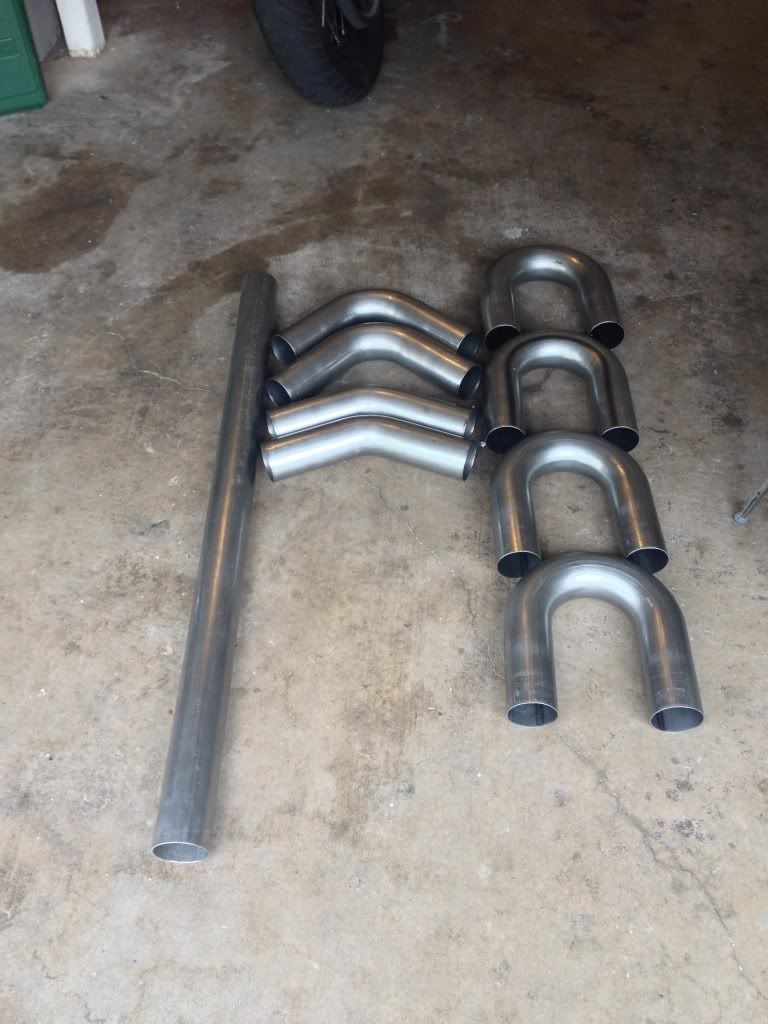

got all my pipe in going t start getting everything fabbed up!

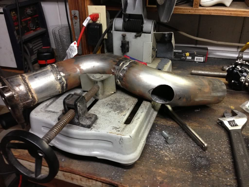

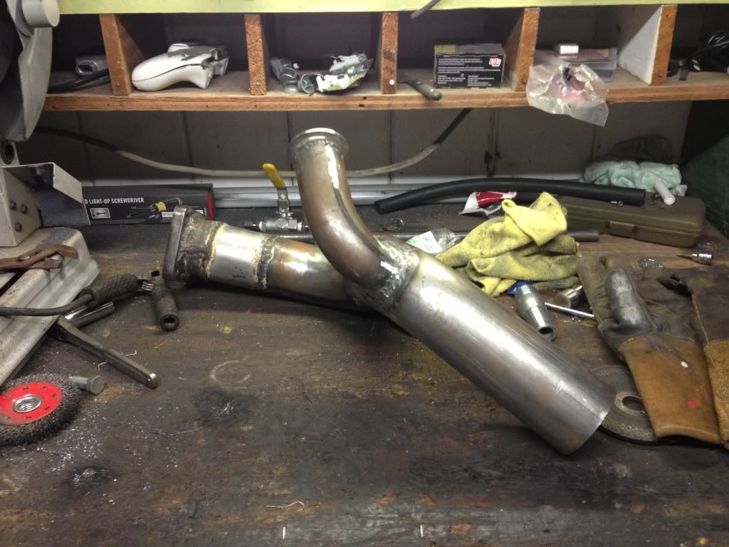

little update!

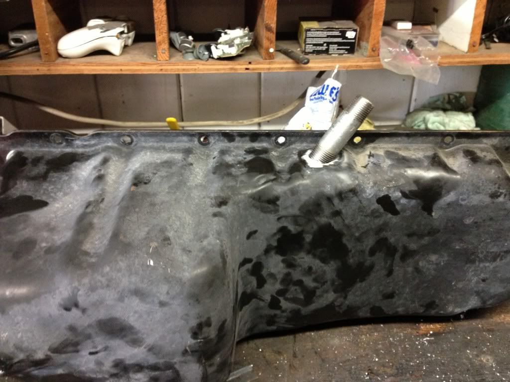

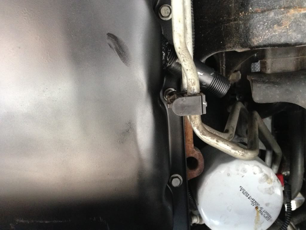

got al my pipe in, got everything fabed up on the hot side,working on the cold side today, got my oilpan drain welded in,Bov should be here any time along with my Eboost boost controller. all I need now as injectors.

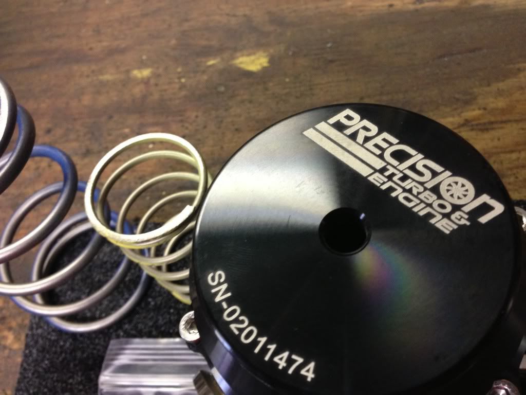

Wastegate
All my pipe

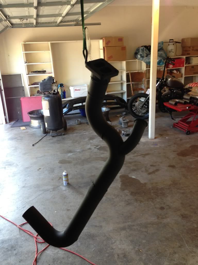

Hot side before I welded up the Waste gate

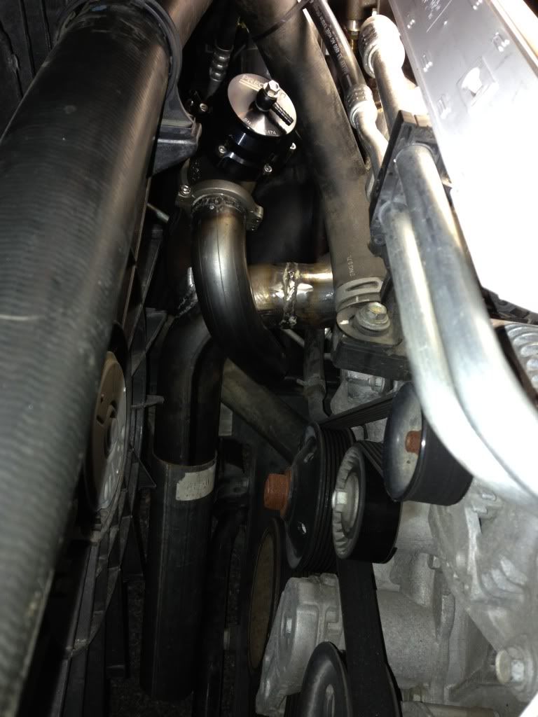

with it mounted on the truck "getting a idea how it will flow"

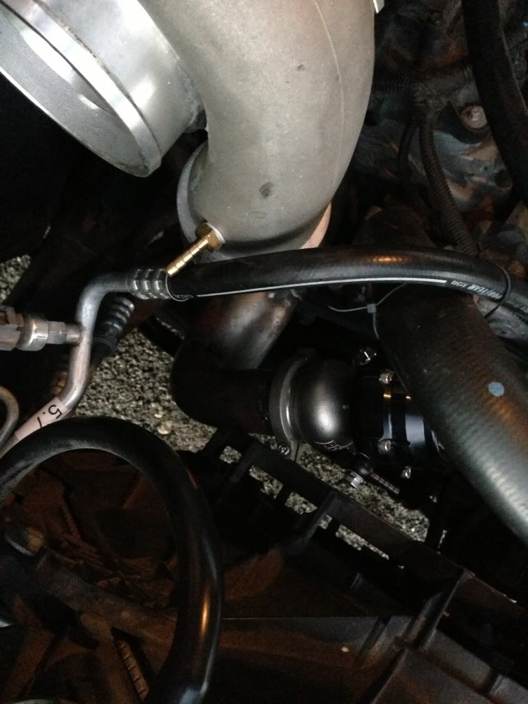

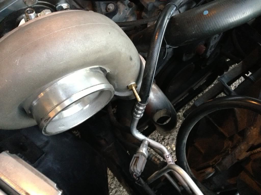

Turbo Drilled and tapped for my boost controller
Hotside
Wastegate installed
Wastegate Blow off tube
Turbo Oil Drain
Had some people ask why it was so long Heres why. a 2" fitting moves it out enough to get past the tranny lines
