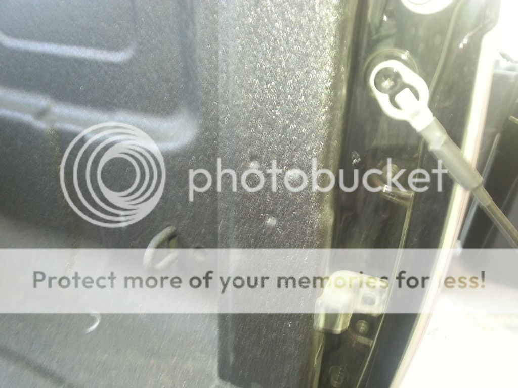

I can tell you this was the one of the easiest installs I have ever done. I watched a few videos (which were not current) but I did have the T-20 torq bit, 9/64 drill bit and phillips head screwdriver ready to go. The hardest part about an install, especially one this easy is remembering to take pictures.
I guess AMP copied Ram's configuration on the bed extender because the package comes with a template to drill 3 holes in each side of the bed to hold the mounting bracket for the extender. So I cut out the template and wouldn't you know it there were 3 indentions from the factory exactly where the holes needed to be drilled. So I drilled the 3 holes and screwed the brackets on.

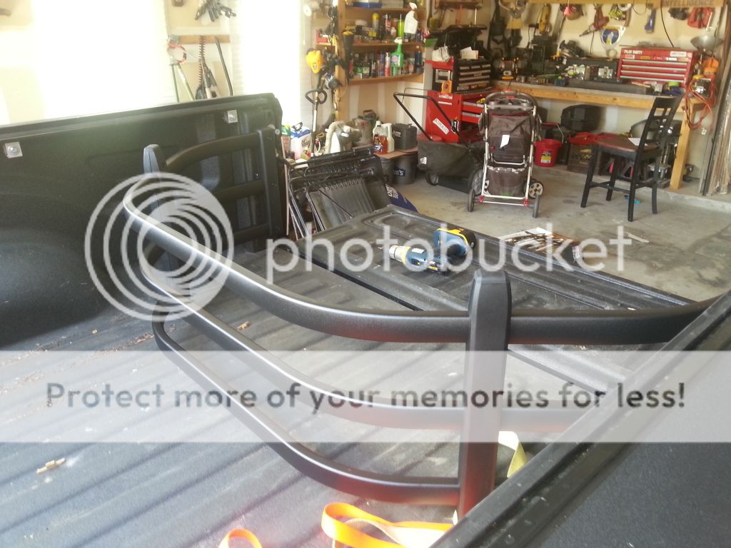

Here is where the process being so simple gets in the way of picture taking. The extender itself comes in basically 3 pieces. The 2 sides and then 3 bars in the middle that connect them. You simply hook the 2 sides to the bed and then position the 3 crossbars on the back and use the supplied brackets to cover where the bars meet each other.
There are also tether straps that with the tailgate down clip into the tailgate where they would secure with the tailgate up.

Fit & Finish - Spot on everything went together EXACTLY as it supposed too with zero issues.
Quality - Powerdercoat looked good, no issues, directions and templates were perfect.
Other - I like how it can be used to seperate items in the bed even when the tailgate is up which will come in handy.
