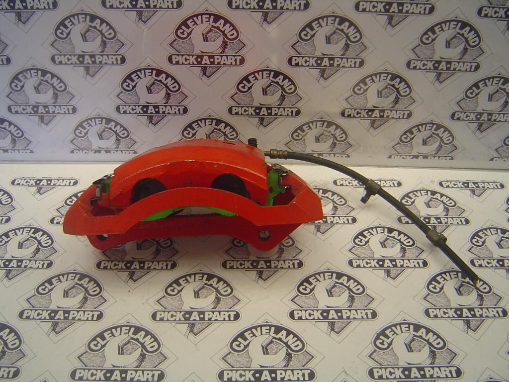

(Had to borrow an image from the pick-n-pull guys, couldn't find one anywhere else)
3. 2004 calipers are large 2 piston sliders. 05-06 calipers are larger 4 piston fixed. These are compatible back and forth, they use the same mounting ears on the spindle and the same exact rotor. Personal preference.
