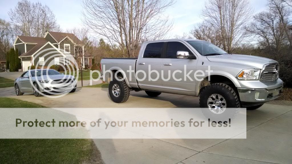

Originally Posted by dew.man View Post
stock
zone d41 (6" frt 5" rr)
17" helo w 37x12.5r17 GY MTR
Very nice.
What offset you running on the rims?
Great call on the lift.
Since carrying it, it's been flying
stock
Truck looks legit!! However I'm more intrigued by the 2015 mustang in the background... How and why do you have one?! Haha

Truck drives/feels very close to stock. The tires stiffened up the ride a bit, but not too bad. Still getting about 15-16 mpg mixed (about 3 less than before).
Wheels are 17x9 with a -12mm offset. Had to trim the bottom/corner of the front balance but no rubbing since.

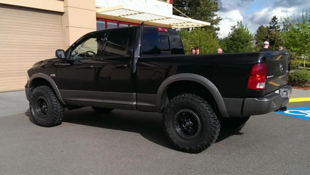

New 2013 Outdoorsman
2" level installed with 285/70R17's
2" level with Fuel Anza's and 315/70R17's
4" Zone lift with 3" rear springs
37x12.50R17's
