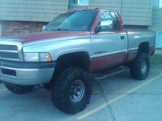

ive got the 97 but dont think theres much of a diffrecne and all i have is a 3" BL and 2" level kit and have 35x12.50s and they are on ford 15" rims and fit fine... only problem i have is the thornbirds that are on it have huge lugs on the sides of the tire and when i turn all the way the lugs barley start grabbing my 4link heres a couple pix
and aww what the hey heres a vid so you can see how the truck kinda sits... cell phone special...
