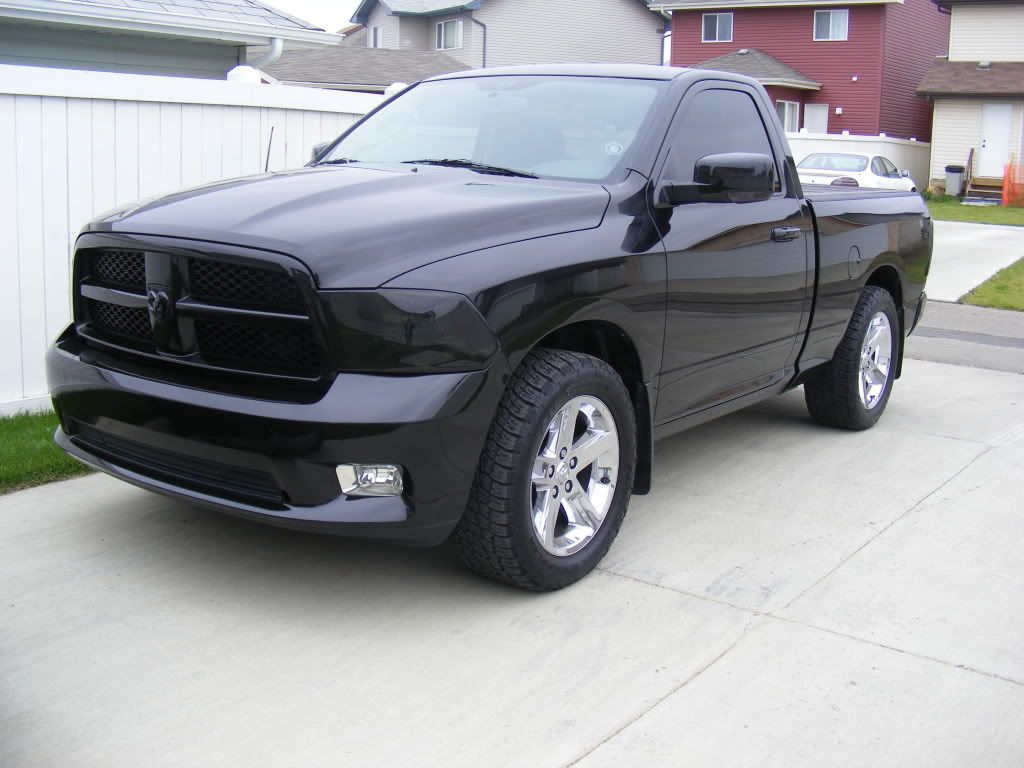

My Drag Radials are mounted on -12 offset 17x9 Moto Metal wheels,
You'll probably want to invest in some Bushwacker pocket flares to protect the side of your truck.
Tires are 295/45R17 Mickey Thompson Street ET's and stick out about 2"-2.5"
My 305/50R20's on 20"x 9" stock wheels with +19 offset are only out about a 1/2"
