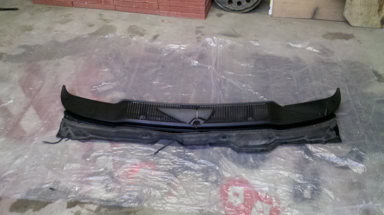

I laid some drop plastic down and rest my wiper cowl on that to limit any dust on the floor.

Sand the parts down with the 150 grit sandpaper. When that is finished, go over it with the 800 grit to smooth out some of the deeper scratches. After that, spray it all down with the cleaner/degreaser, and wipe dry. You may repeat this process until you feel the grime from sanding is all removed from the surface. Let it dry for 5 minutes, then apply a good coat of adhesion promoter, and a second one about 10 mins later. Let the adhesion promoter stand for about 10 mins, then apply your first coat of perfect match paint.
Make the first coat rather light, where you still may see some black through the paint. You should apply 3 to 4 coats of paint, with 10-15 mins in between each coat. After the last coat, allow an additional 5 mins to dry. Then get your spray bottle of water and 2000 grit sandpaper, spray down the pieces and wet sand away. This is just to smooth out the paint before clear coat. After the wet sanding, spray the cleaner/degreaser and wipe the parts clean again. While this is drying, take a Twisted tea break!
After a good 10 mins of the parts drying, apply 2 coats of clear coat, repeating the wet sanding and cleaning after the 2nd coat dries. Then apply the final 2 coats, and allow to sit for about 45 mins or so, to fully cure to the parts. Then re-install.
