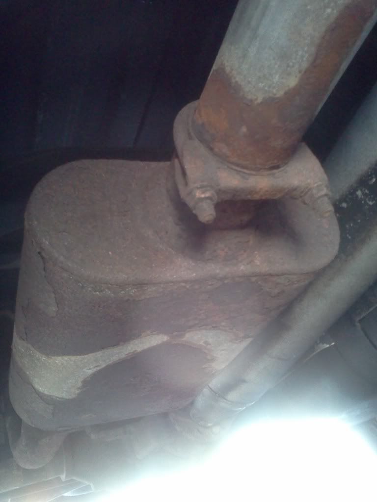

Hello All,
So, my muffler is rusting really bad and I was curious if anyone could tell what kind of muffler this is. It is single middle intake and single offset outtake. 2.5 inch in and out. It's 13" long, 10" wide and 4"tall. It does have a MagnaFlow weld-on tip, but not sure if the muffler is MF as well, or stock. I LOVE the sound of it and would be curious which one it is. Any help would be great

Judging by the shape and the rust, I'm thinking Flowmaster...Magnaflows are made of stainless steel.

Definitely not a magnaflow.
Looks like a flowmaster or flowmaster knock off.

Thanks for the knowledge! So, should I replace it with another FM or put in a new MF? I do drive through a lot of salt with all the snow we get up here, so a stainless steel would be nice. I am just afraid of not being happy with a different/new sound.

Magnaflow will sound different (probably quieter at idle and low rpm's/low throttle, but probably just as loud or louder when you step on the gas). Magnaflow will give more power than flowmaster though, every time.
