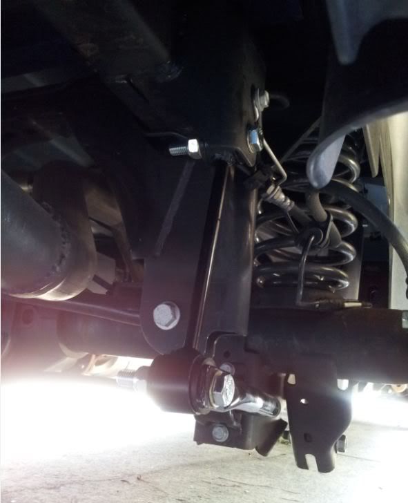

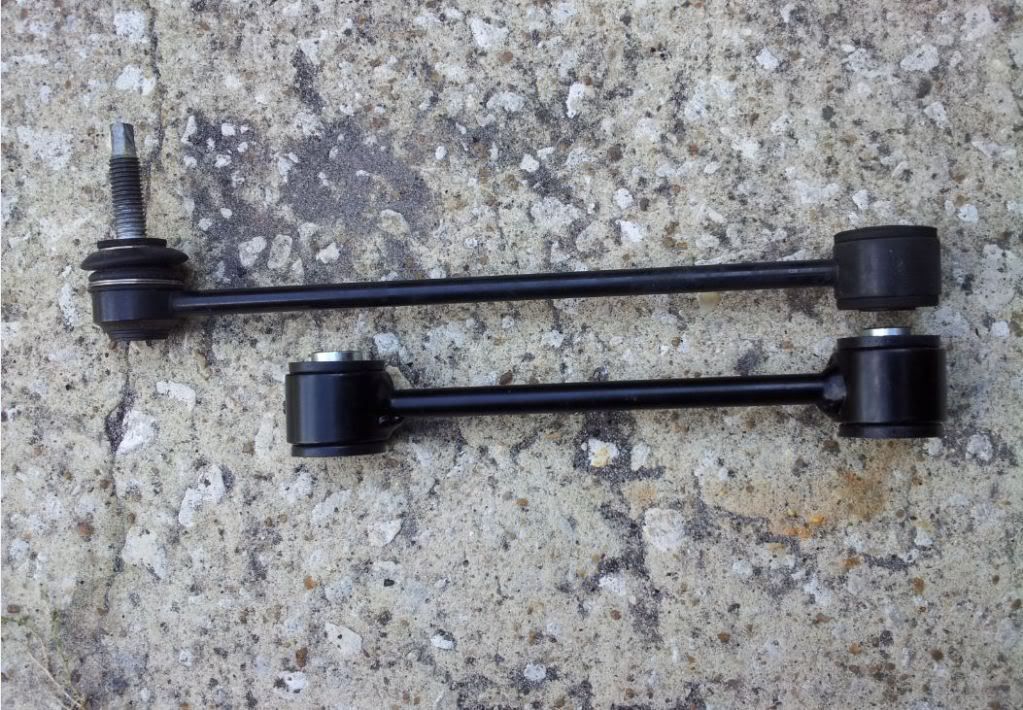

Installed the End links, fairly simple so there's no real install pics. Put the rear end up on jack stand to keep it as even as possible side to side, remove the OEM end links using an 18mm socket and wrench for the top. Use a 18mm wrench to loosen the bottom. To keep the ball joint from spinning, I use an adjustable or Vise-Grips. The instructions say use a 16mm, but they're wrong, go figure lol Now the new dog bone styled end link bolts can be installed using a 3/4 socket and wrench. Adjust the sway bar by rotating it up to line up with the holes and slide the bolts through to hold it in place. Tighten them up by had first then use a Torque wrench and tighten them down to 76Ft Lb's. That's it.
Comparison

Complete
