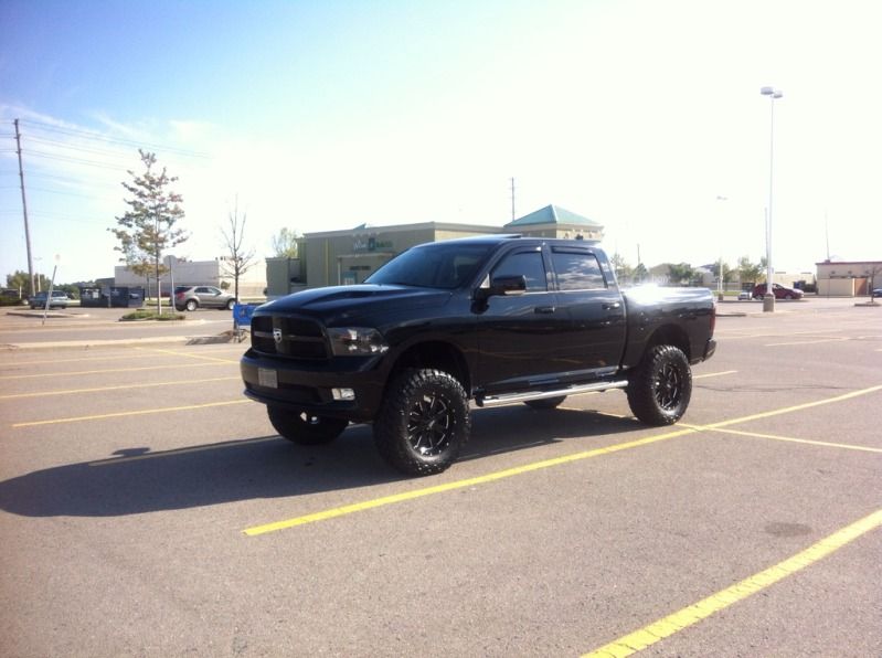

Recently Lifted mine!
For those wanting know what I did and what I put on - I did the 6" RCX, Bilsteins set to 2.1, 1" Rear Coil Spacer, 20x9 Moto Metals on 37" Nitto Trails
Before measurements:
Front: 36.5"
Rear: 39.25"
Now
Front: 46.25"
Rear: 46.75"
Before
After
Before
After

^^^^Awesome looking truck. I can't wait to lift mine.
What's the offset of the rims? I've been back and fourth between -28 and -44. Can't make my mind up. I wish I could find a 2012 ram with -44 offset so I can see how it looks.

Rim spec is 20x9, 0 offset/5" back space.
for a -44 offset have a look at flyhiguy85 thread, found HERE
