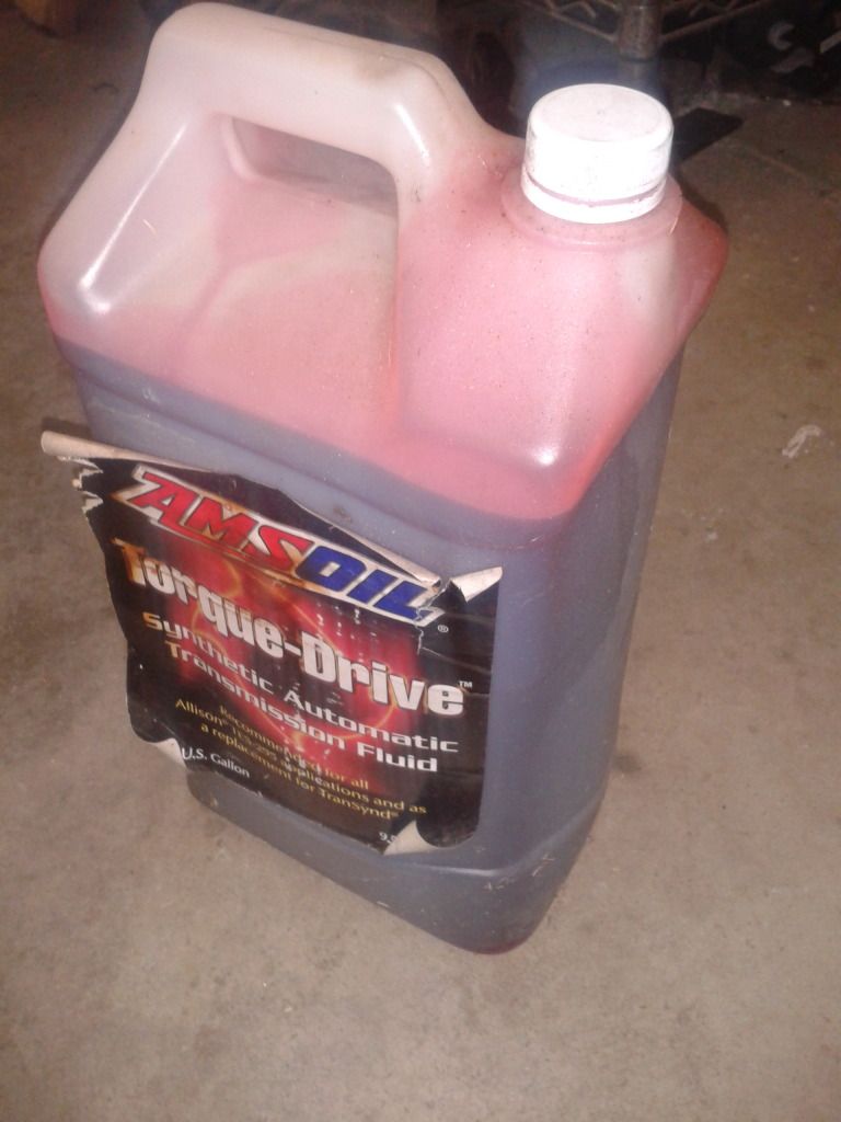

Could i use this stuff? i bought it for my old 2006 Dmax with allison trans but sold the truck i
I can't access the picture (our firewall at work blocks Photobucket and all other image sharing websites), but if it's not labelled as MEETING the ATF+4 spec, then I would not use it.

It says:
Amsoil Torque-Drive Synthetic Automatic Transmission Fluid
Recommended for all Allision (something I can't read here....trans model it appears to be) applications and as a replacement for TranSynd
Sean

I'm with TransEngineer. I wouldn't use it unless it specifically says it meets the spec.
