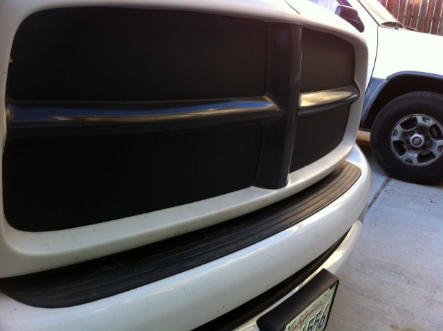

my track mod...

my track mod...
nice!

there has to be some direct airflow thru the radiator (most of the time). One thing I thought of trying if i were to close the grill (track mod), is to run ducting from my foglight holes to the front of the radiator. then you don't have the parachute effect like when the grill is open...
