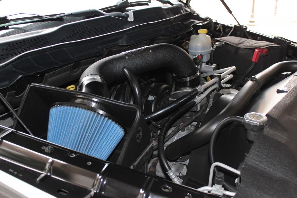

I know, I know, I plan on getting it powder coated gloss black. But the wife keeps tight reigns on the truck funds. Just put tires on and next I am putting on an AFE intake, and drilled and slotted brake rotors with new pads. Then a few small projects, like painting the wheels, and I am going to have to repaint the front grill, It is starting to chip where I didnt do a very good job preping the first time. then when the bumper comes off I am going to plasti dip the exhaust tips.

thanks guys I am really loving the intake and exhaust. I still want to add headers and a tuner in the future.

fastNugly, thanks, working with the fiberglass is not too bad just very messy. and you have to be patient. as for the filter I now have the aFe stage two on it now. I went with it because it let me retain the lower half of the stock air box jsut for this reason.
Sean, I wouldnt say I notice a big gain or what ever. BUt i did notice certain situations that the truck seems to be more efficient. I have heard that the air temps a the intake are not much over the outside ambient temp with this mod. and that is always good to be able to get cooler air to the motor.
