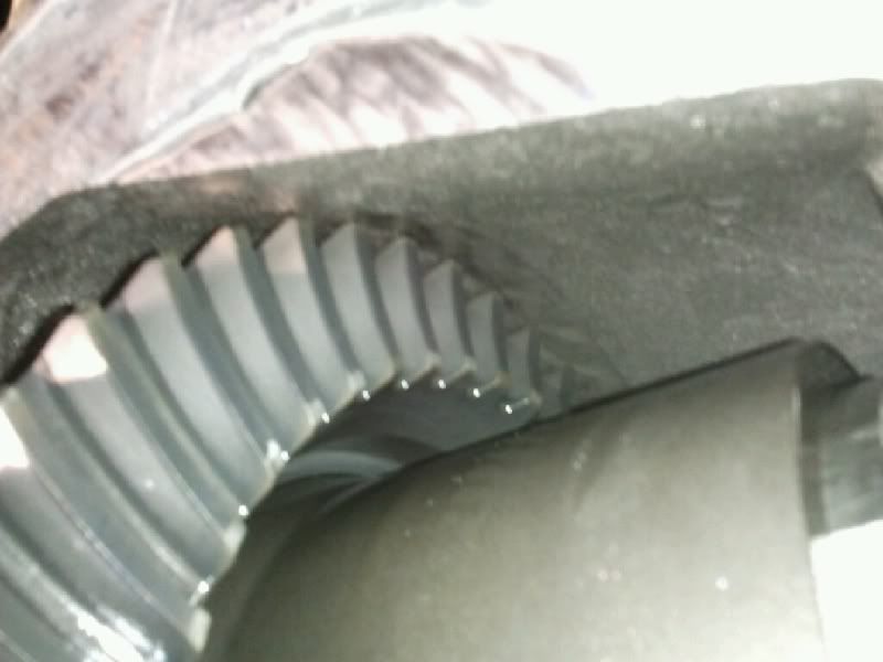

i dont want to waste my time going to 4.10 when ultimatly i want the same set up as my 2WD 4.56 with a detriot tru trac and to keep the shift schedule half way decent and the speedo semi correct you have to do a reflash ohhh and i hate friggn MDS i work for Dodge and i think it is the stupidest thing in the world so i cant wait to turn it off. Be aware when you do 4.56s in a 2010.5 n up you need to shave the inside of the diff from August 09 and up they made the diff housing wall 20% thicker to be stronger so if you dont shave it it will hit the house , here is a pic with it all done on my 2WD its super minor but you can see were i grinded it away
And of course im super proud of my custom diff cover so i have to show it off haha

Ohhh I got ya. Hypertech has been claiming to have a speedo fix for out trucks for a but now. Im not wasting my money since I want a programmer. Why didnt you go 4.88 in that 2wd!? That would be beast!
Ive heard you had to shave some. Im wondering if thats an issue with the new ZF rearend? I know they have to redrill my LSD so the ring gear will bolt to it.
Ingo on the diff cover plz. Does mag Hytec make one for ours? I know im lazy and havent looked. It jus hit me the other day to get one since Im gearing my truck.

Yup Mag hytec is the only company that makes one that you can bolt up with zero modification , i went cheap and got an Oasis cover they are a new up and coming company with huge claims so i gave em a try and low and behold i have to bring the cover to a machine shop and get the fins milled down cuz the panhard bar rubed it then i brought it to the powder coat shop and had em do the peppered finish , all n all coulda saved money n got the mag hytec haha but now it stands out from the rest so im happy
