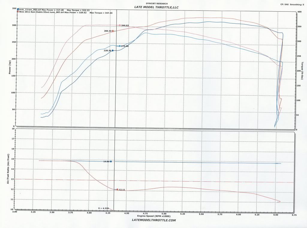

I strapped my 2010 CC 4x4 to the rollers today. I ordered a Corsa exhaust last night and wanted to get a new baseline, because its going back after the exhaust is on. The fist time the tuck was dynoed was on the 87 diablo. Now its on the 93 tune. The truck has the tune, 180 stat and catch can. Everything else is stock down to the plugs and air filter with 35k on them. Needless to say I'm pretty impressed with the results! I gained 12hp and 25ft lbs at the peak power. 330hp and 347ft lbs were the numbers. Out of a tune only truck all I can say is WOW. I never expected that. Here is the dyno chart with the 87 and 93 tune in comparison.

330/350 rear wheel numbers?

Yep lol those are the number. I was shocked to say the least. Never thought I'd those number out of a tune only 4x4.

Nice numbers man!

very nice numbers..not too far from my 370/390 i did a few years back..haven't dynoed in awhile...

Thanks for posting your dyno numbers. I have a 2010 as well and was curious to know what the stock baseline would be. I have a CAI and planning to do some exhaust work. If I can find someone around here with a full vehicle dyno, I'm going to get it on the rollers too to see what it does when the work is done.
