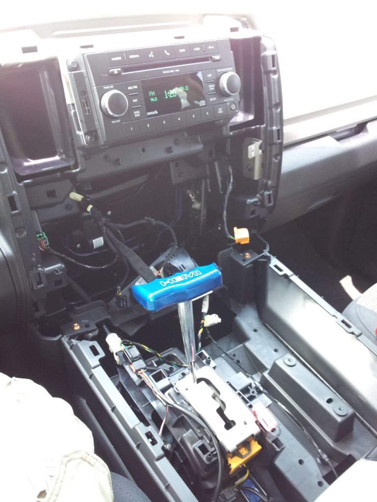

Negative bud, you can keep your heeter ad AC controls, it detaches from the back. you can see mine here just behind the shifter it's just face down

OK perfect, how do the side vents near the doors come off?
Also theres a small silver pieces on steering wheel.Around the front controls for scrolling through the computer. DO these come off also?

Side vents pop out very easily with either a flat tip screw driver (carefully) or use a trim tool. Same goes for the silver bits on the steering wheel but it does take a little work to get them out. Also disconnect your battery while doing them because you're going to be pushing on the center horn area occasionally when prying them out. The buttons pop right out of the trim pieces once you get them out as well.
