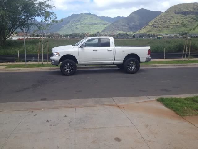

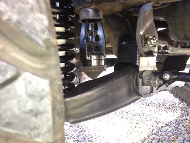

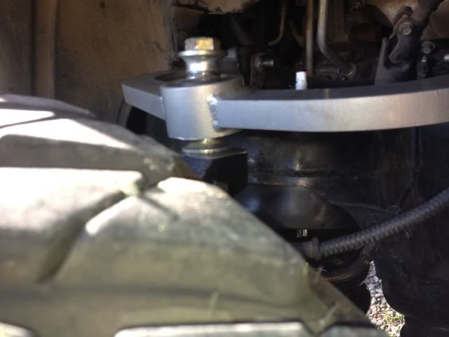

hello everybody, i've been a long time lurker and post mostly on the other dodge forum. well i just recently installed and can confirm that the 06-08 fabtech front lift will fit on the 09-11 ram 1500's. i don't know about the 12's, i haven't seen the front suspension on them yet. i did have a 7" cst lift installed but i needed a couple more inches to help with the rubbing i was getting with my 22x11 fuel hostage's and 35's.
so i currently have the 06-08 fabtech 6" lift stacked with my 3" cat coil spacer and i also have a 1.25" body lift. so i have roughly 10" of lift.
heres some pics
2009 dodge ram laramie 2wd

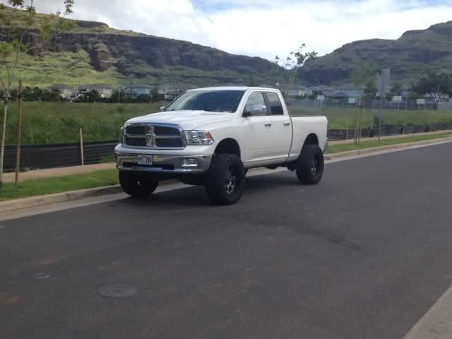

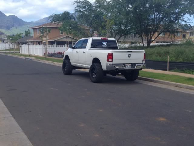

looks good. i dont understand why they dont make a drop crossmember lift for the 09-13 2wd rams?

That offset is just insane man
Nice looking rig though, the flares really add some looks
