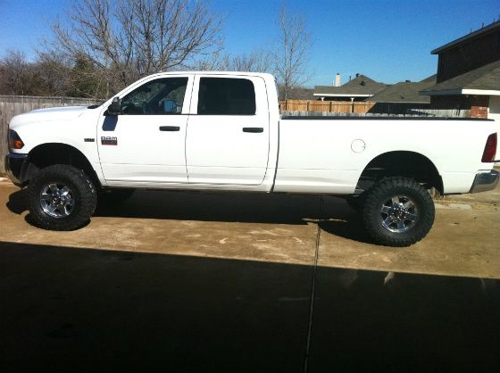

I went with a Rough Country 5" lift (actual lift was about 4.5" front with new coils and 4" rear with block). I ordered it from TGC so I could get it with Bilstiens, and I ordered the Bilstien stabilizer. Stock wheels with Toyo MT 35". Very slight rub on passenger side at full right turn, corrected with 1/4" spacers, because I wanted 0 rub. Any after market wheels would have less offset than stock and would have cleared easily. Search my posts and you can see a detailed post of the install. I'm deciding on which fender flares to get now.

Nice truck!

Nice rig!!, 5'' it must be really tall, you can easily fit 37's. Pictures don't really grasp the height of these trucks. I was looking at the RC lift from TGC. What I like about TGC is that you can order various kits with bilsteins, I think bilsteins make or break the ride.
