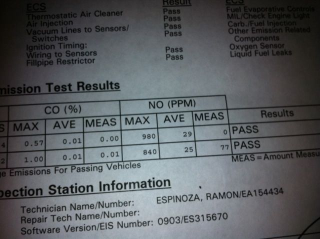

can you believe i pass smog with this?
Your truck sounds awesome...I like the electric cutouts too!

Originally Posted by 07HemiRam View Post
Thank you for your response chefred112! That is exactly what I wanted to hear because I'm planning on doing a cam swap when I'm on spring break next year so just starting to do my research. I am in Lake Forest CA about an hour and a half away from Murrieta CA. So you have 2 different custom tunes? What cam are you running? I am looking at Inertia Motorsport's Spartan cam because I want a pretty big cam. Also do you take off your BFI intake for smog?
Spartan baby!!! yes i do take it off for smog..here is how it looks for testing..
you can't even tell where the nitrous is either...smog guys didn't see anything out of the ordinary..
