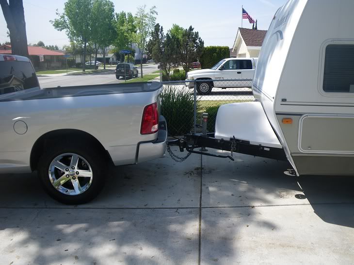

Here's the pic with the trailer attached with 5 psi in the Airlift bags. I've pulled the trailer near home just to test how much pressure I should run, and the truck felt just fine without any weird handling issues. As I said in another post here, I went to 20 psi to insure no porpoising or bobbing while hitting bumps or dips. 20 psi adds another inch to the rear height from this pic, but more importantly it doesn't let the rear suspension compress aggessively which would then allow a possible strong rebound. I just completed a little over a 1000 mile trip this past week, and the truck and trailer performed excellently and handled really well. I was in the hill country of Texas on lots of secondary roads with low water crossings and sharp corners. The airbags alone did a great job of keeping both truck and trailer in full control.
That is good to hear. Peace of mind.
