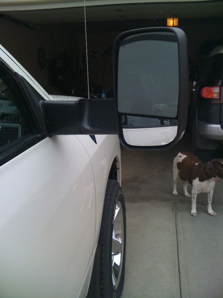

Go for the OEM 2500 Mirrors. They are the Flip up, Signal & Puddle light with heat & electric. They are totaly plug & play for 2009 up on the 1500.
Part No 55372070-AH
55372071-AG
How much for these mirrors?

Just beware, if you didn't have turn and puddle lights on your mirrors the new ones will bolt on, but only the heat and tilt functions will work. Your door module won't include the wiring for all of the pins and a flash won't activate teh turns and puddles. Speaking from experience.

found replacement towing mirrors on the web the ones that flip up just like Ram have on them cost belive they were 139 each cant remmber where right now. I needed un power kind. with power features they were 50 more.
$599 CDN Eech

hey col, I called my dealer as I want to swap out my sport mirrors as for the towable ones, I have the puddle lights and signals in my current ones, will the towable type bolt on and plug in with all functions working??
glad to see pricing has come down a tad, the dealer quoted me $399each side.
Yes plug and play in your case.
Hi JC.
Sorry not been back in touch sooner. All functions work. Just plug & play. About 15 mins per side.
