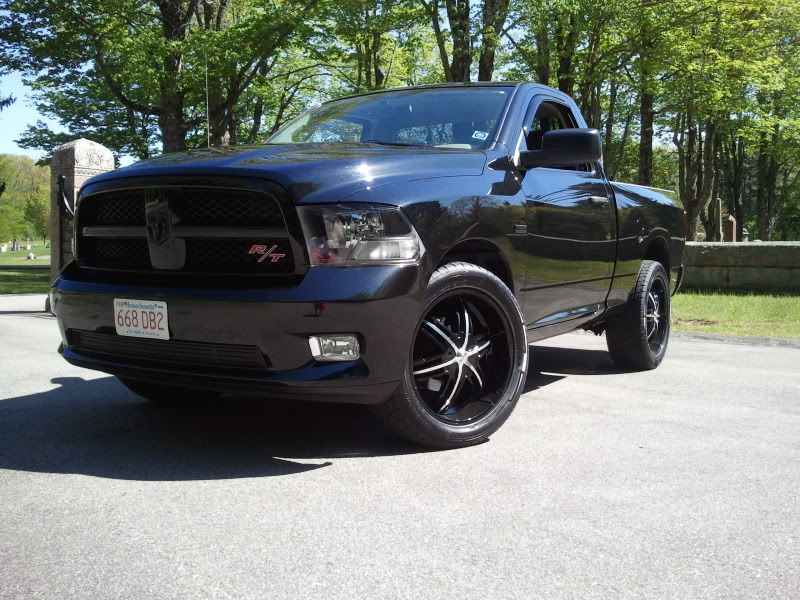

I went with the 305 on 22's coast me 2,015 in total
very nice setup , but thats well over twice my budget for new tires right now. I am really leaning towrds the 295/50/20 unless i get feed back from here that they just wont fit. I really want to find some pictures of them on a lowered 4th gen first with stock wheels. but it looks like I might be the first.
