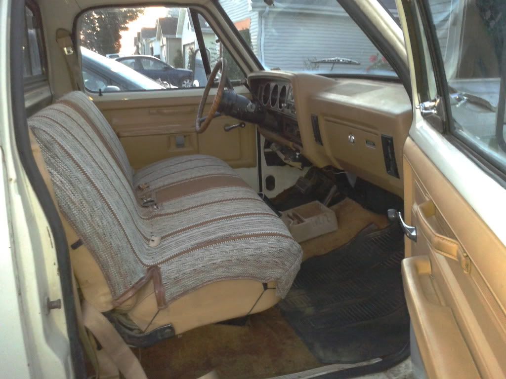

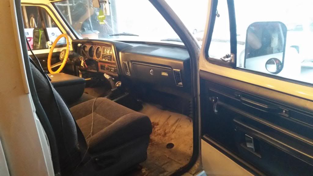

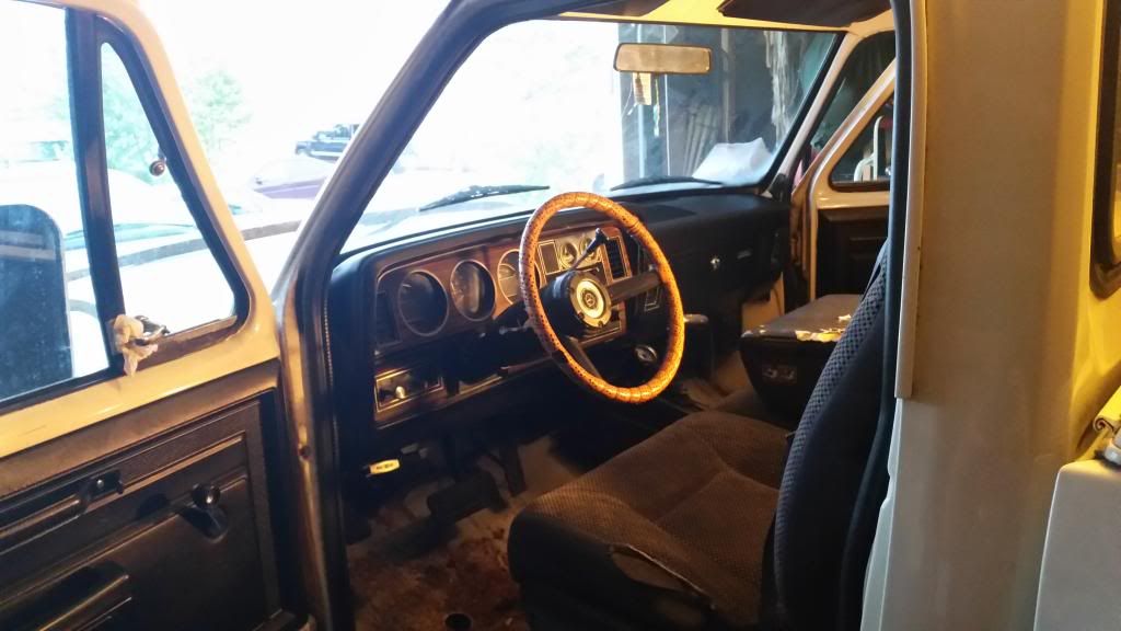

This is what I started withhttp:// this so far is it.http:// I think it looks a lot more sporty and custom.

That is looking sharp!!
Are the door panels new or painted?
How do you like the bucket seats? That is something I have been considering - vs reupholstering the original seat. Call me old fashion but I am partial to the charm of the old-style bench seats.
Is that just a cover on the steering wheel or is it a wrap? Was thinking of a leather or rawhide wrap for mine.

The dash and all are original. I used 2 cans or mate black. I love the bucket bench. My daily driver is an 01 1500 quad cab. I like the integrated seat belts. Now what I found is it did take modification the Gen 2 extended has a flat floor. Now the regular cab is raised like a gen1. Also some of the seats that are integrated have a module to control seat belts. That has to be wired for them to unlock and work. But now that's done it's so worth it to me. And if you wanted to change your speedo to white. LMC sells a kit to do it plus needle paint. And the steering wheel is a wrap. Soon to disappear.
