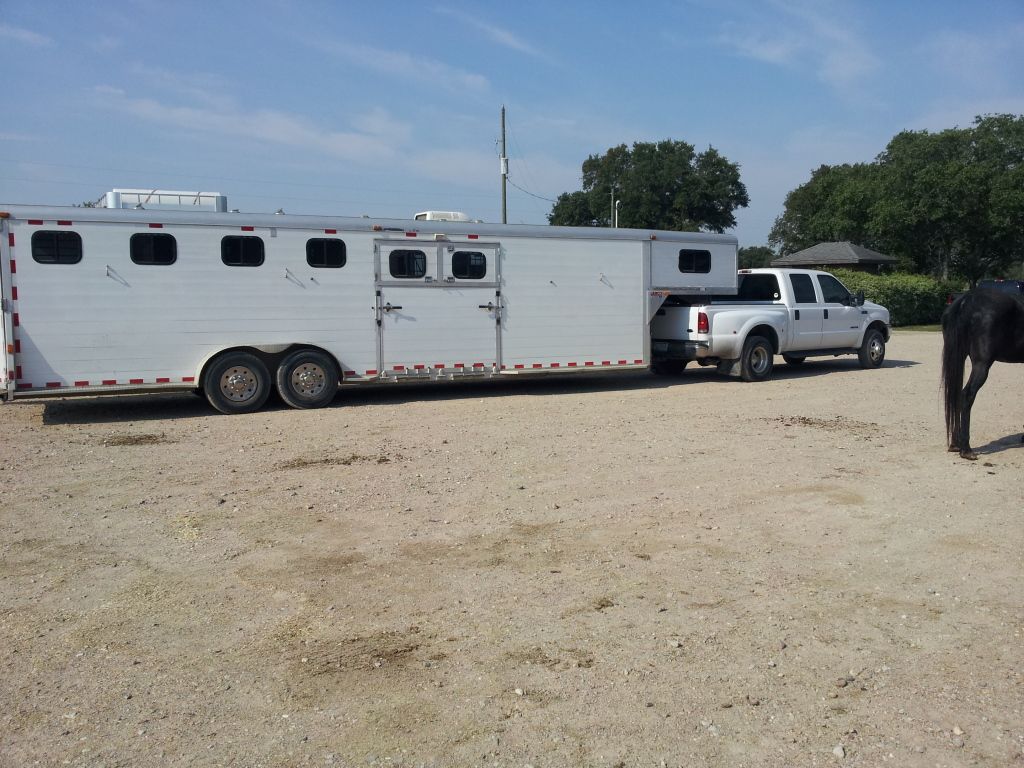

I think you are referring to hooking up the trailer.
I know of two simple ways that worked pretty effective for me. There are some yellow reflective poles that you can buy they are about 3-4 ft tall and are magnetic. They stick to the ball and the hitch. Once you line up, the poles get knocked off.
http://www.cabelas.com/rv-travel-tra...:referralID=NA - Link for reference.
Or when your out and just need to do it quick grab some white tape marker or something visible and tape a spot on top of your tailgate so you have a reference where exactly the ball is at.
As far as backing. Most of its practice. If there turn is execptionally difficult I take the time to line my mirrors out further to where I am going to place the trailer.
Experience - tow 2-6 horse trailers (often cant see the back of the trailer because its takes forever. and its all estimating how close I am to buidling/cars etc..)
and I think its harder to back up a smaller trailer but easier to correct.
But nothing beats that ooo S$#t moment when you hauling a fully loaded truck and trailer and you need to stop on a dime and you know its not going to happen.
