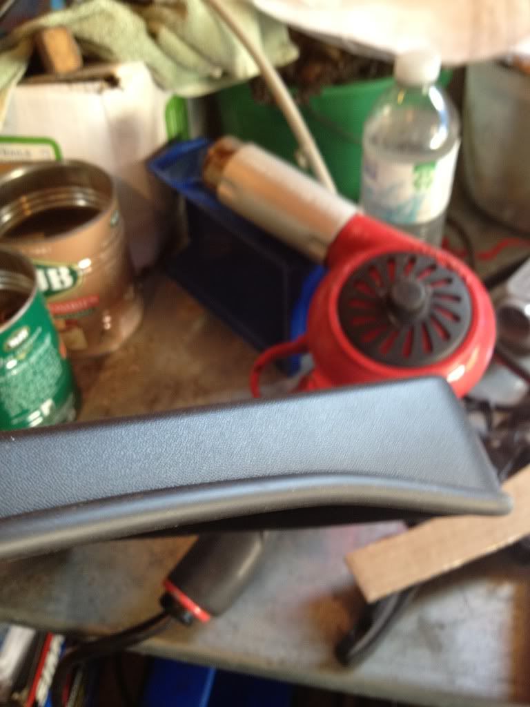

Well, a couple of quick mods tonight, License Plate braket and Tow Hooks, the license plate mount I got off of RansRam thread I think, to be honest can't remember where I saw it,
First the necessary Tools, its hard to see in the pic, but the mountains are blue
I started with a license plate holder from a 2010 Ford Escape
The first thing you do is cut off the two rabbit ears, all you need to do is score it with the knife and then break them off
Now you have to match the shape of the bumper to the holder, for that a piece of cardboard works well, and I might add this is probably the most time consuming part of the job
After you are happy, then you mark the bracket and start trimming, I found the snips worked best, and there isn't a lot of trimming needed. Not necessarily required, but I keep all my rubber bits from old flares and other accessories, so I used some rubber channel from an old set of bushwacker flares, and this gave the piece a more finished look, not to mention the protection from the hard plastic rubbing on the paint
All thats left now is to install, and the fit was perfect, whoops, how did that R/T get in there
The little ripple at the top was quickly dispatched by the heat gun
