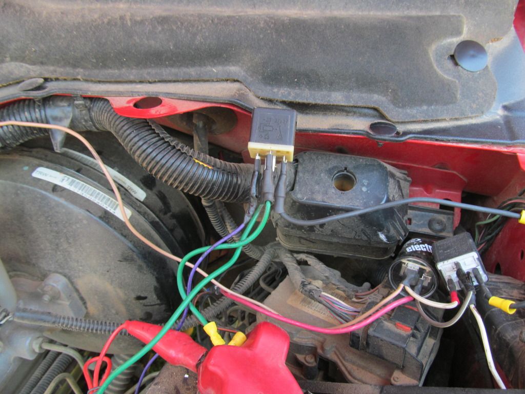

Finally got the switch! Now just havent decided where I want to mount it so for now the wiring is wrapped around my parking brake. Here is a pic of the components under the hood. Just a relay and a flasher button. I didnt like the speed of the 3$ thermal flasher button I tried first so I bought an electronic one 8$. Crimped all the fittings on then put shrink wrap over all of them. Plugged it all up here it is.

So I am about to add a body lift and didn't want to cut and modify the fan shroud. Off to the wrecking yard to find an electric cooling fan. And here is what I came up with, pulled the it out of a 1994 Ford Tarus, $13.
Got home and removed my fan clutch and fan shroud.
I found some scrap metal laying around the house and fabbed up some brackets to hold the e-fan inside of the original fan shroud.
Threw on a little black paint
I used pop rivets to secure the brackets to the fans.
Threw it all back into the truck and wired it up.
I havent decided what controller I'm going to use to for now I just wired it up to a relay and tapped into the fuse box and found a spare fuse slot that only recieves power when the ignition is on, so that is the remote wire on the relay. Just temporary.
Pretty happy with it, we will see how it acts next time stopped in traffic or putting around in town.
