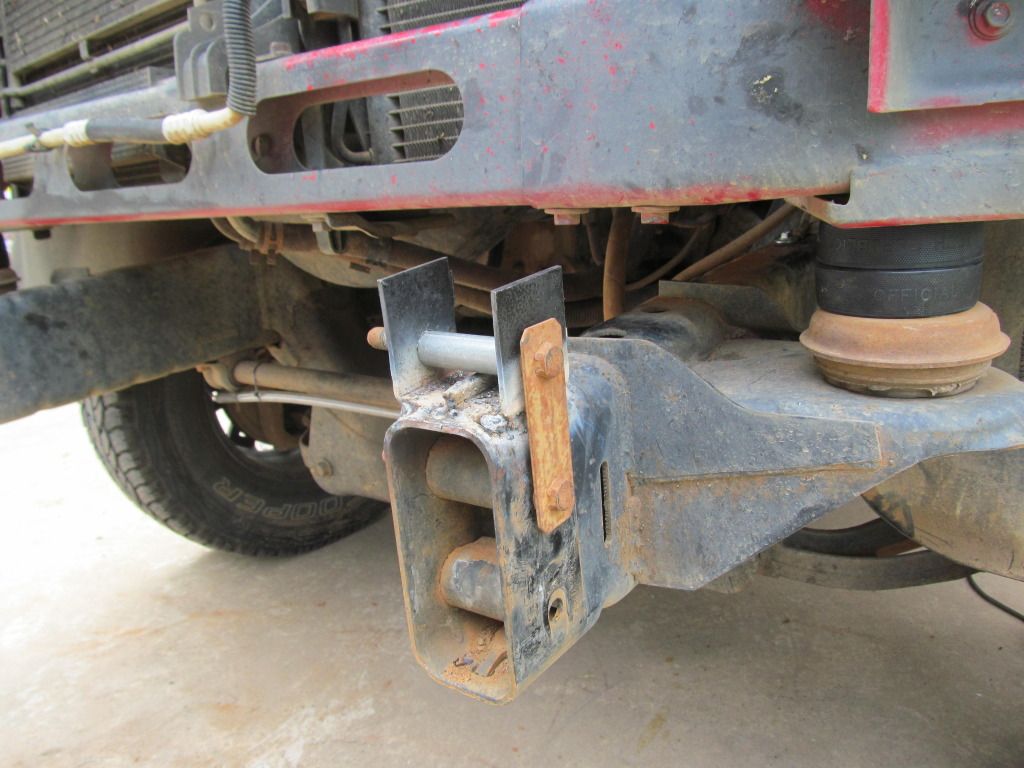

Well its been a while since ive posted cause ive been so busy. But in the mean time I got my homemade 2'' body lift put on, and Im in it less than 100$. All the hardware was about 35$ and my lift blocks (hockey pucks) were 40$.
BEFORE
AFTER
Here are a couple pics of the process
I cut my own brackets to raise the front bumper out of some metal I had laying around.
Welded them onto the frame

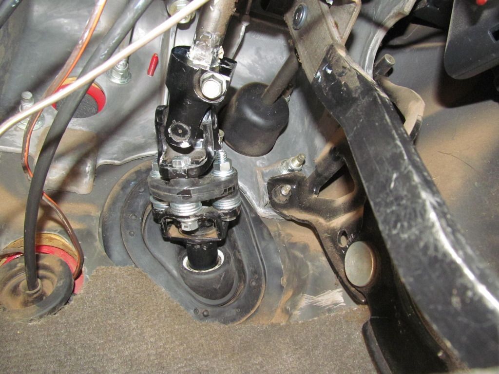

Got dark on me last night so I havent put the bumper back on yet, And I still have to raise the rear bumper. The intermediate shaft was just a shade too short so I needed a steering extension, Until I priced one $125. So I decided to figure some way to extend it myself.

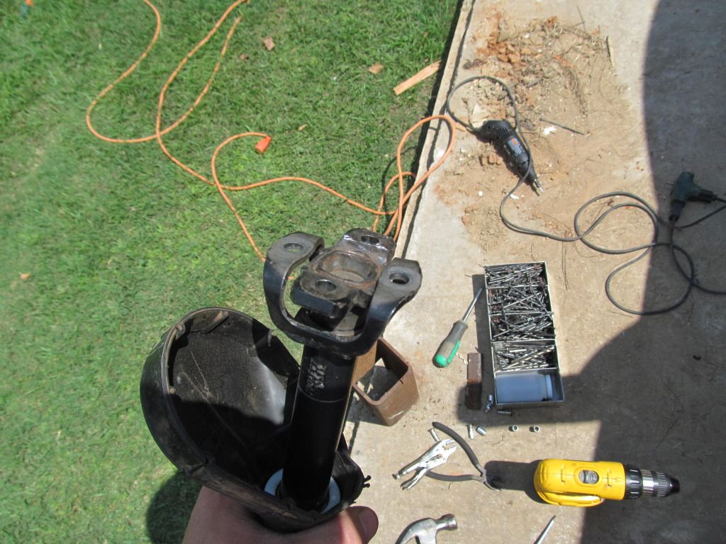

Drilled the rivets out
Got tired of laying in the floorboard trying to work, so I just took the shaft out.
Got some bolts and washers and put it all back together.
Works like a champ! And only cost $2!!

Ive just got a $100 welder from Harbor Fright, its insane hard to weld a decent bead with it, I guess cause its so cheap, but they are plenty strong so as long as its covered up it doesnt bother me. Just a suggestion
