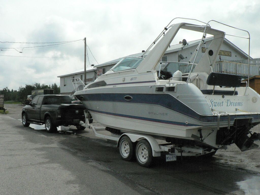

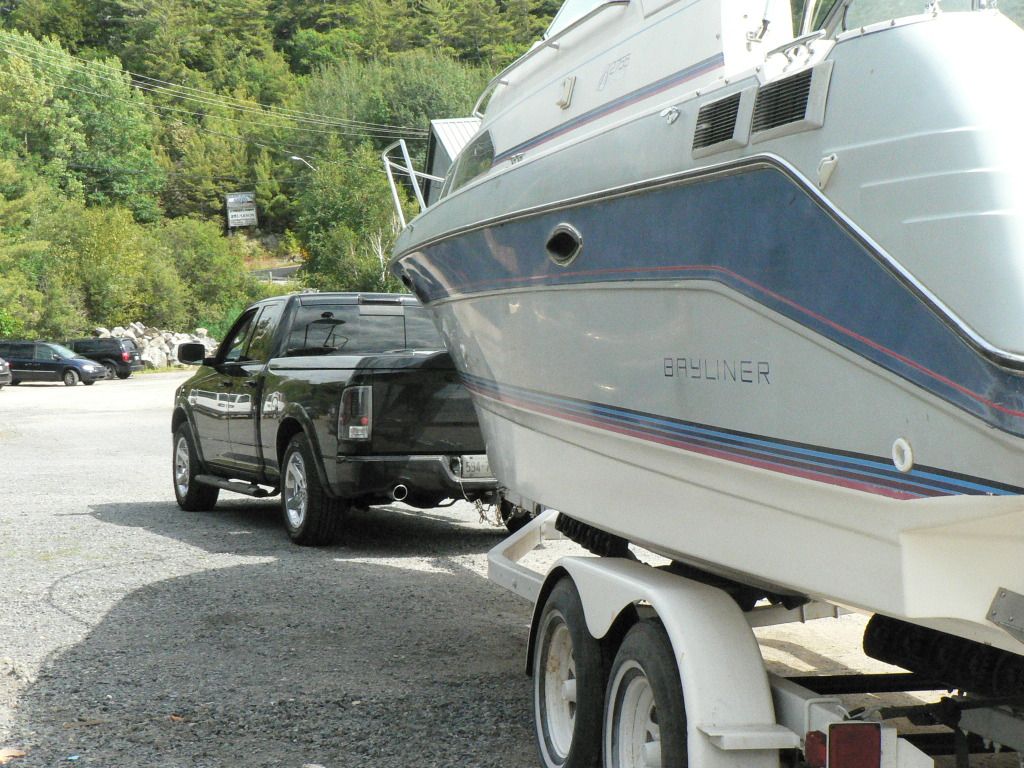

So yesterday I towed a friends boat from Sturgeon Falls to Parry Sound Ontario, about 200km distance over somewhat hilly roads. I thought I'd give a small review of the experience. The boat was a 27.5 bayliner on a tandem trailer. Overall weight was 6,000lbs with approx 600-800 on the tongue. My RAM pulled this load like a champ with hardly any sway. It definitely affected my mileage and it seemed that I was always on the throttle to keep the load moving. I figure my mileage while towing was down around the 10mpg range. Average speed was between 80 and 90 km/hr while towing. The temperatures while towing were as follows, 69C trans, 99C oil and 97C coolant. Outside air temp was between 22 and 25C. I am very pleased with how these RAMs perform under load. I know I know, pics or it didn't happen so here are a couple of cool shots from yesterday,

Ya it was a big friggin boat coming at me in the rear view mirror :LOL: Like I said, I had the feeling that perhaps the trailer brakes were on and holding me back the whole time I was towing it. I checked the trailer wheels when I got to our destination and they were all cool to the touch. Also, the engine and trans temps were not all that bad so perhaps a different gearing would make a difference, I wanted the 3:92's grrrrrr. Anyway it's nice to know it can handle the task when called on.
