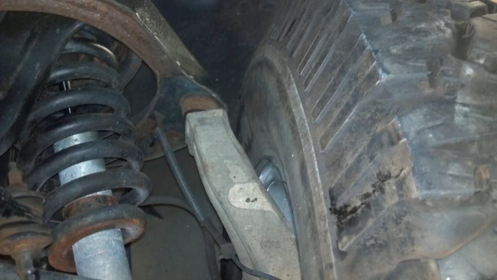

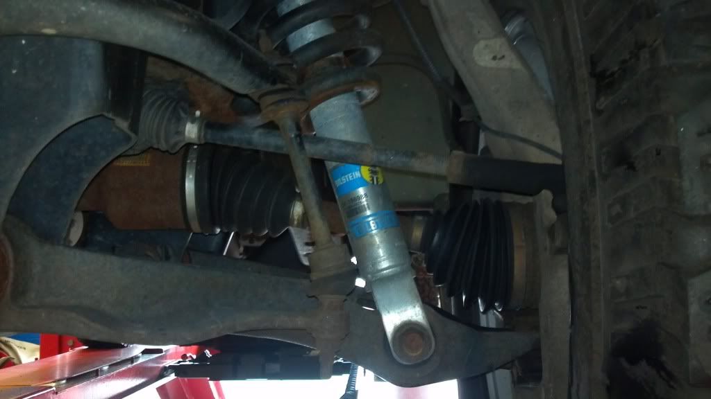

i have 285 70 17 on my stock 17 rims on my 06 ram that is leveled out with plenty of room between control arms

the stock size for my truck was a 265 70 17 and i put a leveling kit on and i liked my rims that came with the truck. so i figured 285 70 17 would be max limit but i think i can get a set of 285 75 17 to fit.
