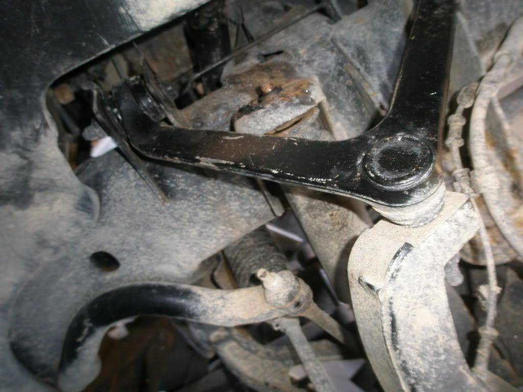

5) My shocks came with new hardware for front shocks (i think all will but make sure before you do this step). I took a reciprocating saw
and went just below the top plate and cut the bolt like this.

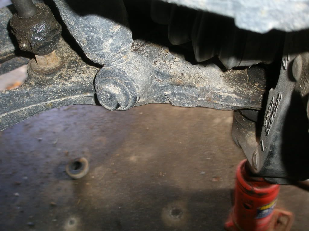

6) There is a bottom bolt also to get out and you DO NOT want to cut this bolt. I sprayed it with PB blaster and it came out fairly easy. Once this bolt is out your shock will fall so be careful.

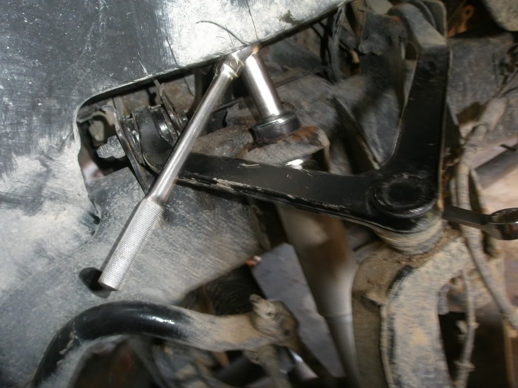

11)tighten the top bolt by using a 19mm open end wrench and a 19 mm socket like this . The 19mm open end wrench will hold the shock so it doesn't spin when you tighten the nut down. You want to smush/expand the rubber spacers
You are now done with one side, just repeat this process on the other front side.

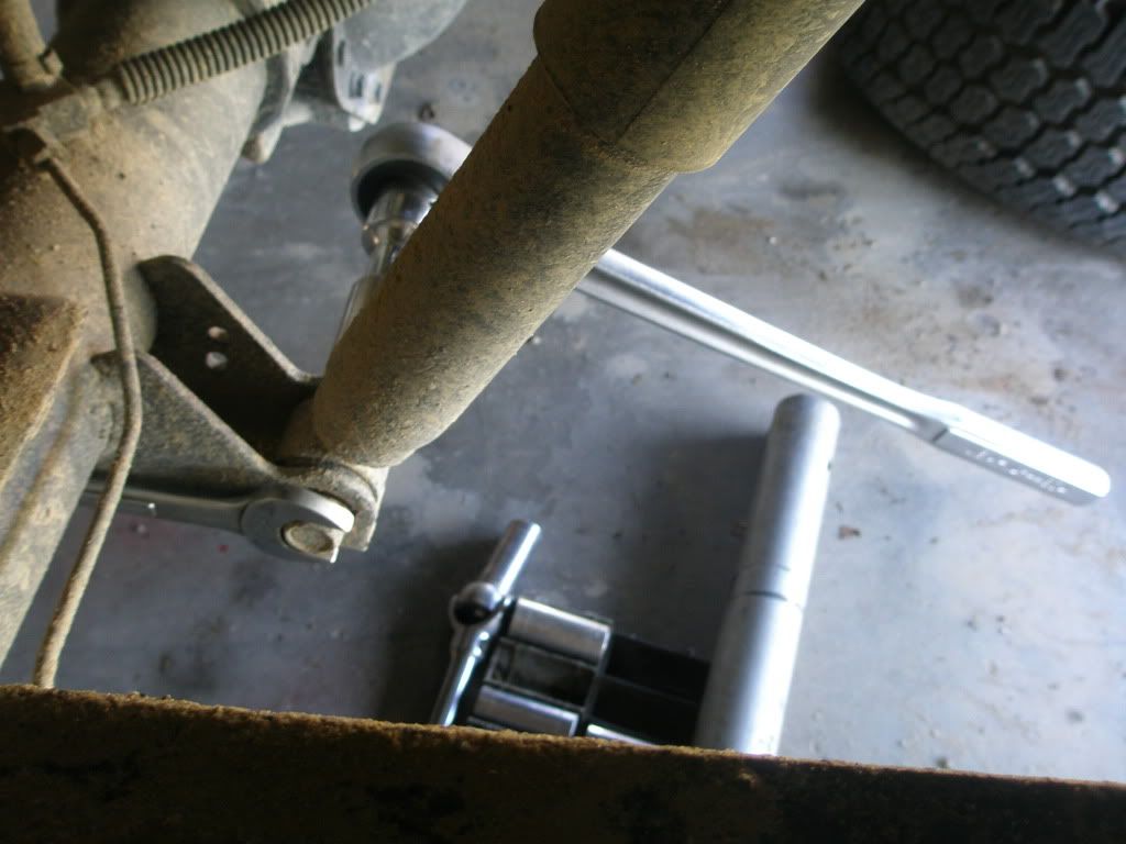

4) now you will want to get an open end wrench (7/8 I believe, but I may be wrong.), and also a socket in same size for the lower bolt. Let the wrench catch on the axle and remove the nut with the socket.

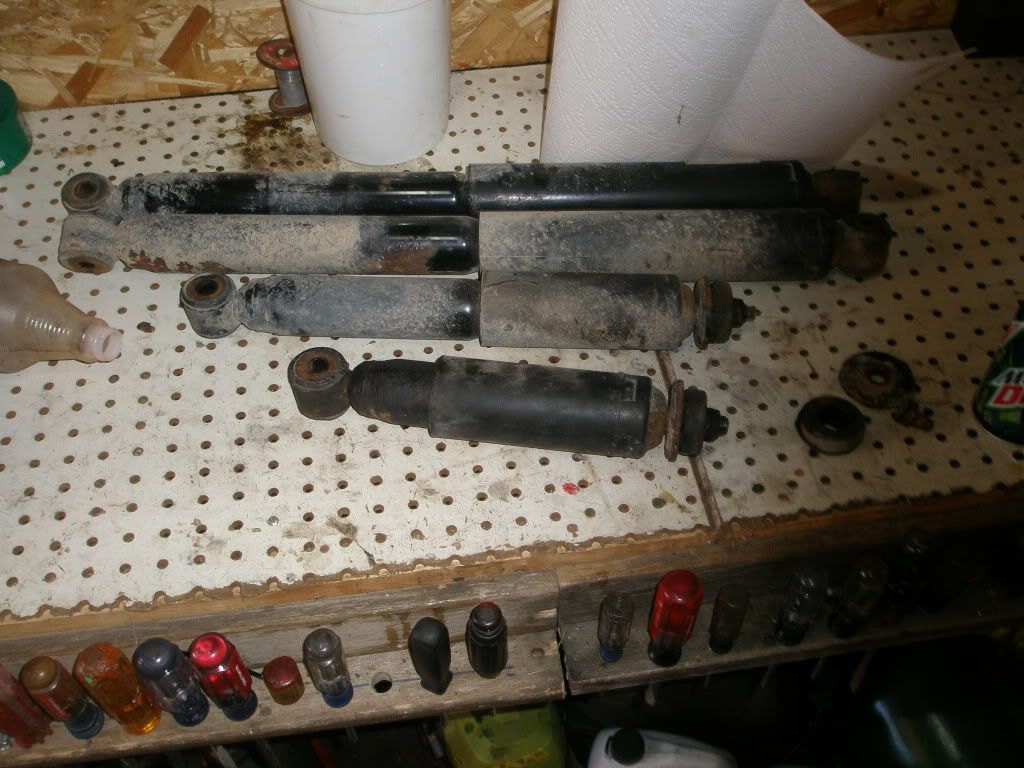

Here are all of my shocks.
As you can see they were in rough shape
