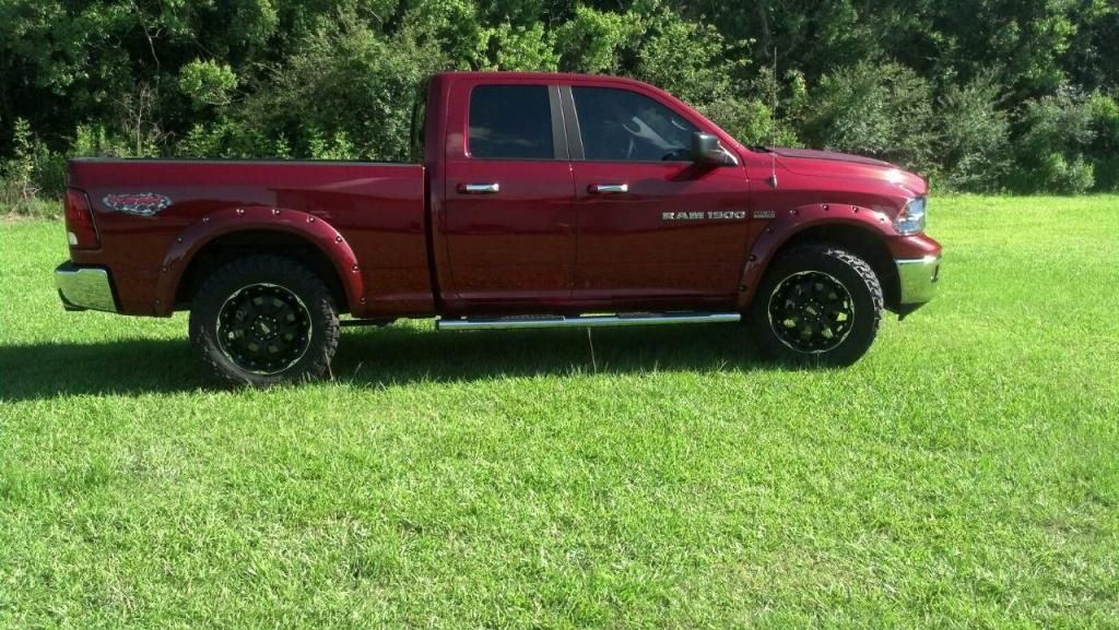

my truck
2012 Dodge Ram 1500 4x4 with goodies and 6'' Fabtech lift

Originally Posted by daviddup78 View Post
my truck
Truck looks good
