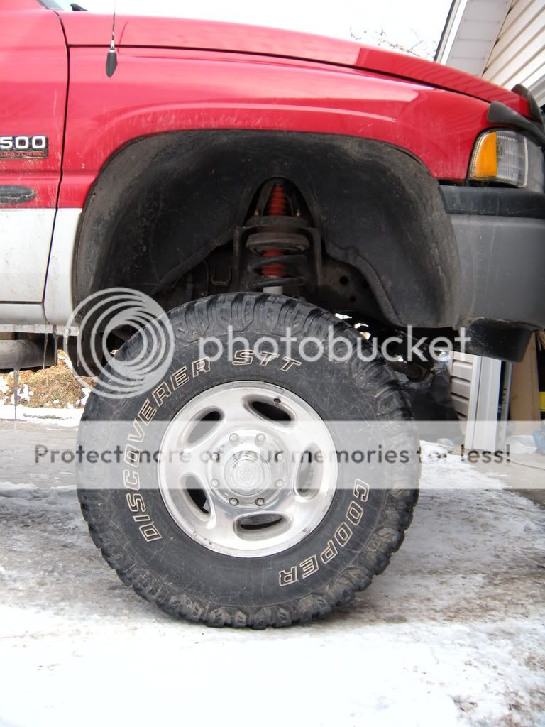

even with the 3in spacer, your lower control arms are going to pull the axle back towards the cab, i have a 2500cummins with a 7in lift and i put a 5inch lift on and stacked a leveling kit on top of it and it was way wrong. so bought new control arms from top gun customz. this what it will look like..35's for winter
with my 38's for summer

so the first pic is without the new control arms? Because in the 38's pic the axle looks centered. I feel with 3" spacers it wouldn't be as bad as 7"
