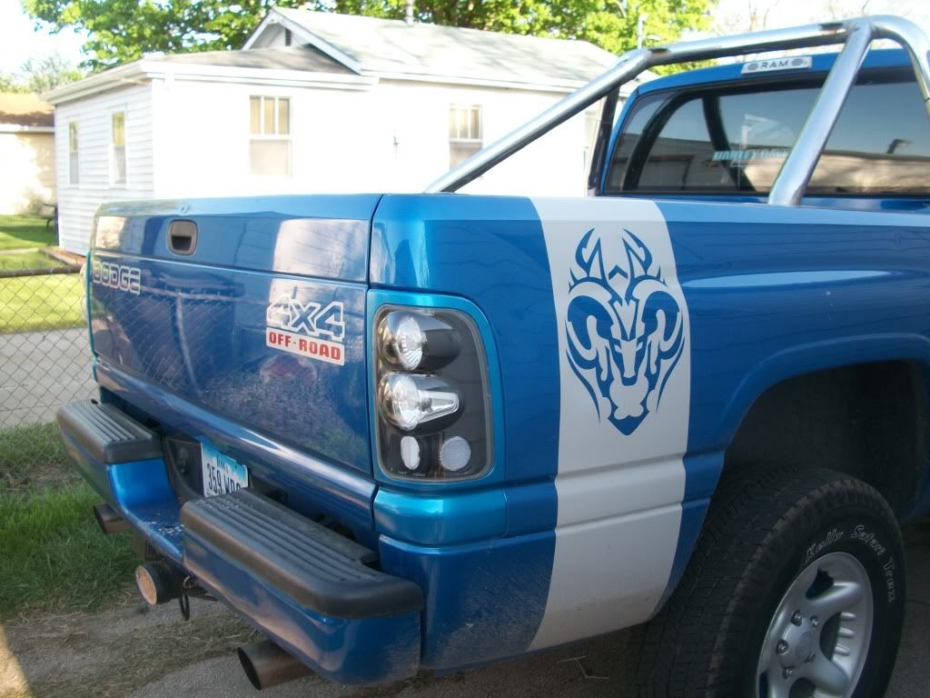

Ebay and craigslist for the cheapest probably. You can also check out car-part.com there you can search junkyards.
Most lights are paintable. I bought mine of ebay and they were black.
Now I am trying to decide if I want to attempt to bake them open and paint the rest of the black, but I feel it may be too much blue.
I am going to be redoing the paint so I get it too match better
I think the way they are now looks AWESOME! It matches the non-slip on your rear bumper....
