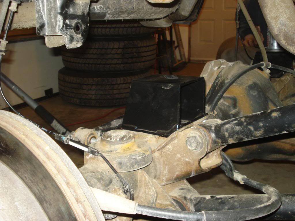

its a very nice kit, extremely beefy parts. only had 2 issues. 1 when installing the differential supports. 2 bolts were shanked out so ahd to add 2 extra washers to each. 2nd is when you install the rear fwd crossmember the bolts provided are too long and come within less than 1/2 a cm of the front axles, so i ahd to cut about 3-4 threads off to give me clearance.
