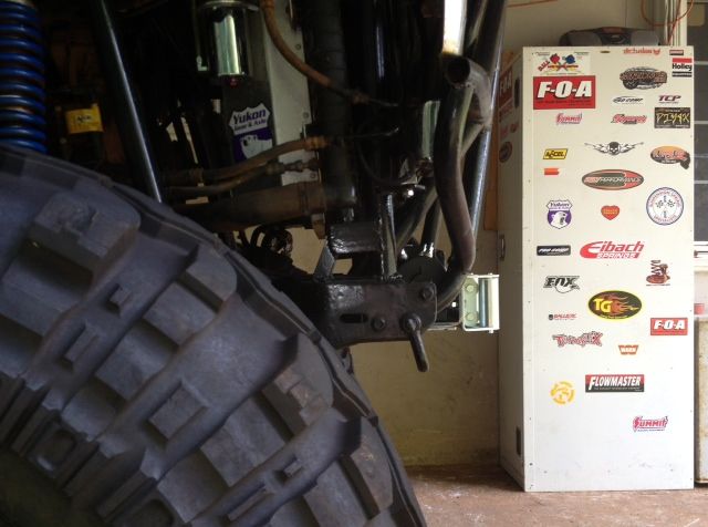

I like these specs. If at all possible I'd like pics of your axle/link configuration. I'd like to see the forward location in its relationship to the frame.

I wouldn't go FOA again the shocks are strong but the machining leaves something to be desired.A friend of mine just got a set of fox shocks for his buggy and they seem to be a lot better shock and only a couple hundred bucks more(that's the next set I'm getting).Here's some pics let me know if you need any more.

Thanks for the pics Tedd. Your front axle is LP? What is it? Looks like the truss and diff cover combo is Ballistic-ish?

Axle is a hp dana 60.The artec truss is nice but the blue torch fab truss worked perfect with my hydraulic ram with little modifications.The hardest thing I had to do with the axle swap was the short side tube link mount(I didn't want to weld to the cast center section).Well my atlas is on it's way and I bent a spring the other day so i'll be ordering a set of custom alcan springs in a couple days and adding a traction bar on the rear. Hopefully everything will be here in a couple months(damn shipping)but for now I got my winch to put on.

My bad on the axle ID!!! lol Your fault for taking pic with the control arm obscuring the diff housing. :P However, I can't tell if it KP or BJ....

Yeah Wh1t3nukle I'm not much of a photographer,it's a b.j. 60 I couldn't find a left side drop k.p. 60 out here, believe me I tried.
