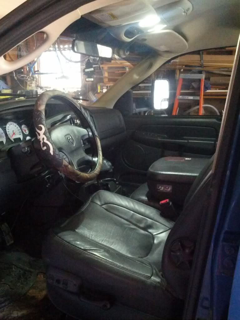

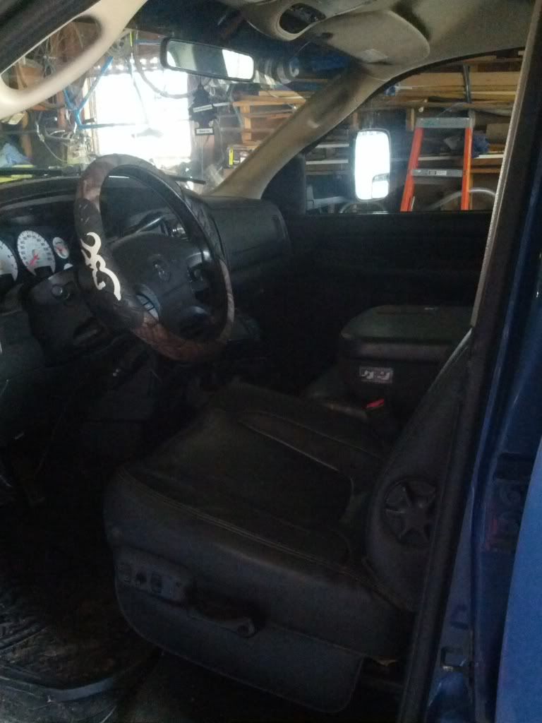

I finally changed my dome and map lights to LEDs and I have to say it is seriously like daylight in the cab at night! I'll also agree that pictures do no justice in showing how bright these suckers are! I was also lucky enough to have superbrightleds.com located near me I was able to do a local pick-up.
Daytime lights off picture:
Daytime lights on picture:
Night picture:
