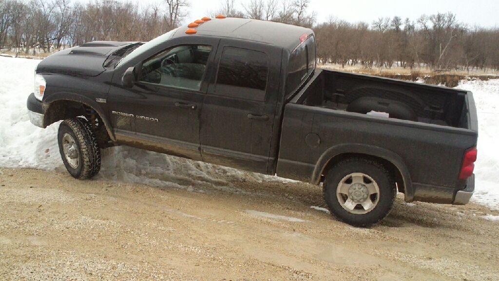

ok i tried again today but no luck with the diffs. they wont lock. not that it matters much with both diffs being limited slip. its hard as hell to turn at all in 4wd on this thing on the street. but im not sure if the sway bar disconnect is working. by these pics what do you guys think? and yes just in case your wondering the hood scoops add 10 hp..... lol[IMG][/IMG] and oh yea i got

this is the other pic i tried to upload but it wouldnt let me

i would say it's not disconnecting , lol, check your relays and fuses

I think its your Switch since its all connected... if your not in 4-Lo then its not going to work ........... By the last picture shows that they are NOT disconnected....because the front right tire should be up in the wheel well and the right back tire should be on the ground... so therefore the sway bar isn't disconnected...
http://oica.net/wp-content/uploads/2..._wagon_lpg.jpg
Do you see how the Rear tire is far up inside the housing and the front tire is bowing inward... that's a sign of the Sway bar disconnection...

thats what i figured. i tried everything to get it to disconnect but it wont. i think i may have to start unplugging the harnesses and check for power after i check the fuses and relays
