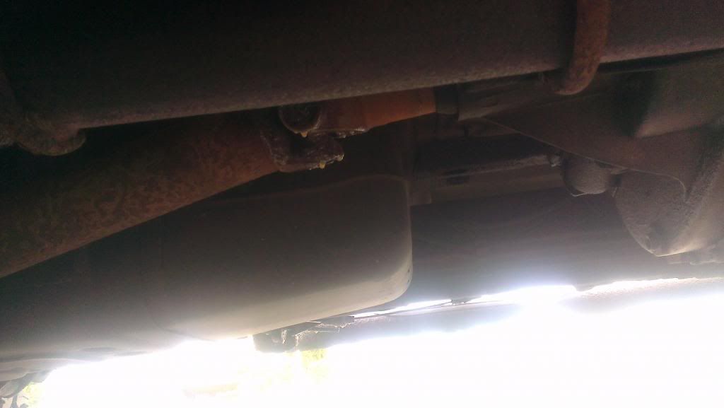

ok so my brake caliper stuck today and i got up under to check the line to make sure it was ok, while in there i decided to spray a few things with rust check....then while spraying the universals it clicked in about this problem. so i snapped a pic of my drive shaft..the transfer case side has i nice angle to it but the rearend comes almost straight out...also my axle looks a little off center judging by tire stickout, very little 1/2" or less...pics are not the greatest
....its hard to get a pic of the front side

Your pinion angle looks about as mine is currently , I will post more pics once I have the new upper control arms installed .

im hopeing when i remove the 1.5" spacers it will help a bit
