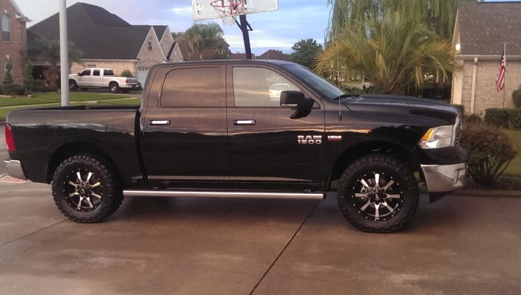

2014 Ram 1500 4x4; bilstein 5100s set at 2.1"
295/60/20 Trail Grapplers on 20 x 9 +0 offset Moto Metal 970 wheels
Close on control arms but no rubbing so far.
  #140
Old 10-01-2014, 12:58 AM
Posts: 17,964
I like it
