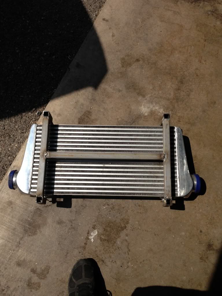

Intercooler is mounted and have had no problems with it so far. Got all the fittings and such for the oil lines for the turbo taken care of also. what kind of line should I use?
Mounted sneaky sneaky like
can't even tell from a distance

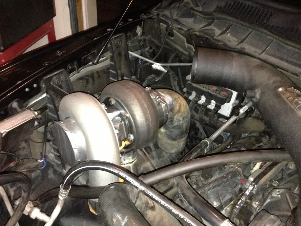

Heres a little bit of a update. Had to redo the intercooler bracket and mounting to the truck. I tried to make everything bolt in but after about 2 hrs of me drilling and still not happy with it I broke out the welder and welded the bitch to the frame. and it's solid as a rock now. Got my PTE waste gate in looks amazing I can't wait to get the truck running to try it out. I also ordered some 3" pipe from Columbia bends 6 - 90's and 45's and 180 bends along with some straights. also got some 4" pipe locally Holy Cow that was expensive "i'll order on line next time" but got my exhaust ran out of the engine bay anyway.. but one to the pictures.
Heres the back of the intercooler 1x1 11gauge square tubing "don't judge me I broke out the old flux welder for this one to see if it still worked lol"

Turbo in it's permanent spot

Looks good. Are you gonna wrap the hot side with a turbo blanket?

Yes the Hot side with be Ceramic coated ,Heat wraped, and I'm looking for a turbo blanket lol..
