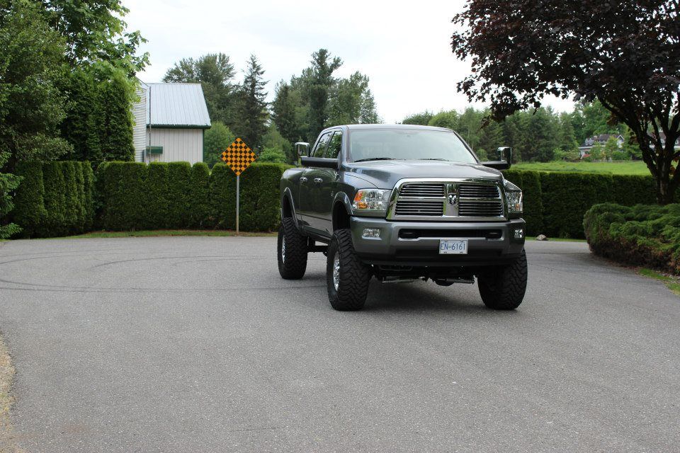

Me standing in front of it for size comparison (I'm about 6'-0" tall):
100% stock compared to now:
