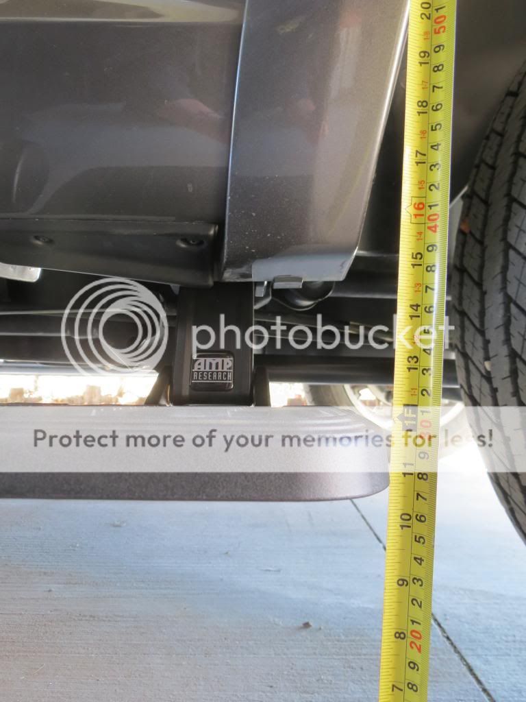

Very nice and I've been thinking about getting one myself. How far down does the step actually drop?
As promised
When I got the tape out it dawned on me that I didn't know exactly which measurement you wanted for the drop.. drop from the truck? Height off the ground? So I tried my best to get a shot of the tape showing both measurements.. I hope this helps! If not, I shall try again!

[QUOTE=KA1OTE;1235154]As promised
QUOTE]
thats perfect. thanks for the pic
i was hoping it was a bit more drop, but at least this way theres something to stand on to reach into the bed. Ill have to wait and find one of those great deals you got.

So, were you wanting there to be more drop and clearance from the frame? If so, you could easily modify the install to achieve this. Simply add a few spacers between the linkage and the bed frame where you drill the holes. The only issue this may cause is the linkage may be visible on sideline view, depending on how many spacers you use. The height of the truck may play into that as well.. making the linkage even more visible on more lifted trucks.
