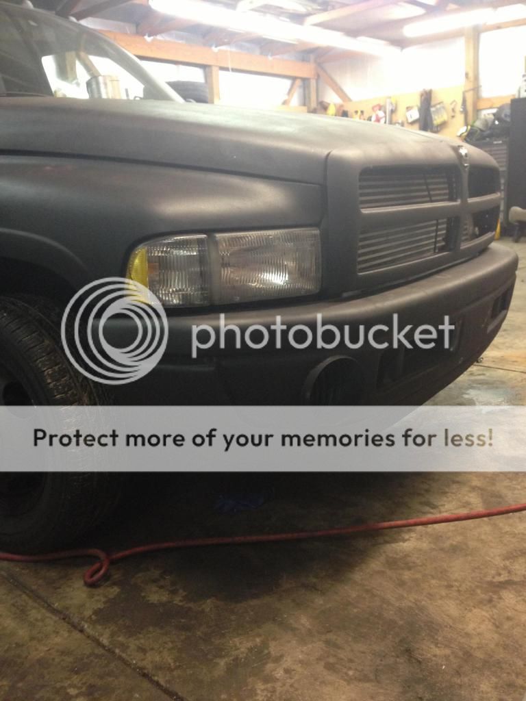

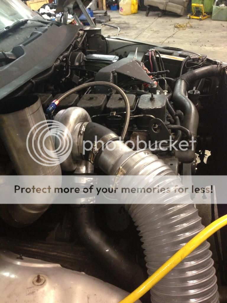

I'm assuming these engines have some sort of an egr system? If so I would like to remove this promptly! Anyone tried water/meth on a 3.7 v6? In the gasser world they seem to get good gains in some applications? I plan on taking the bed off to shed some weight in the rear and lower it about 3" while I'm at it by cutting coils, removing spare tire stuff and unneeded braces, removing tow package, I have other diesels to tow with. Here are some pics I have from projects that might give you some better ideas of what I am talking about.
I also have 4 or 5 hx35 turbos laying around, anyone have knowledge about these engines under boost? I can fab something up if it will be reliable, maybe even some twins?

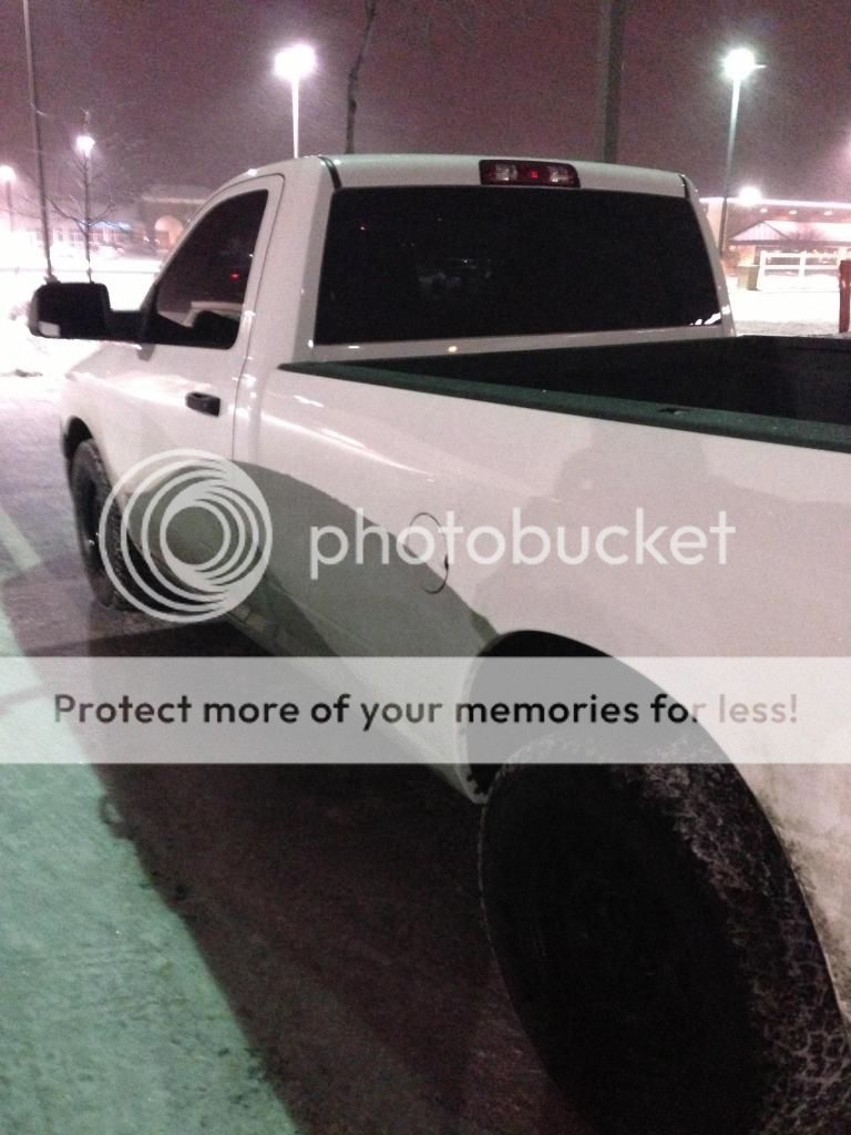

Here's the truck
Material I will use for ram air but will run it to a box with filter
Ram air inlet
Gutted with brace welded in
Hopefully you guys have a good idea now, hope this helps!! Thanks
