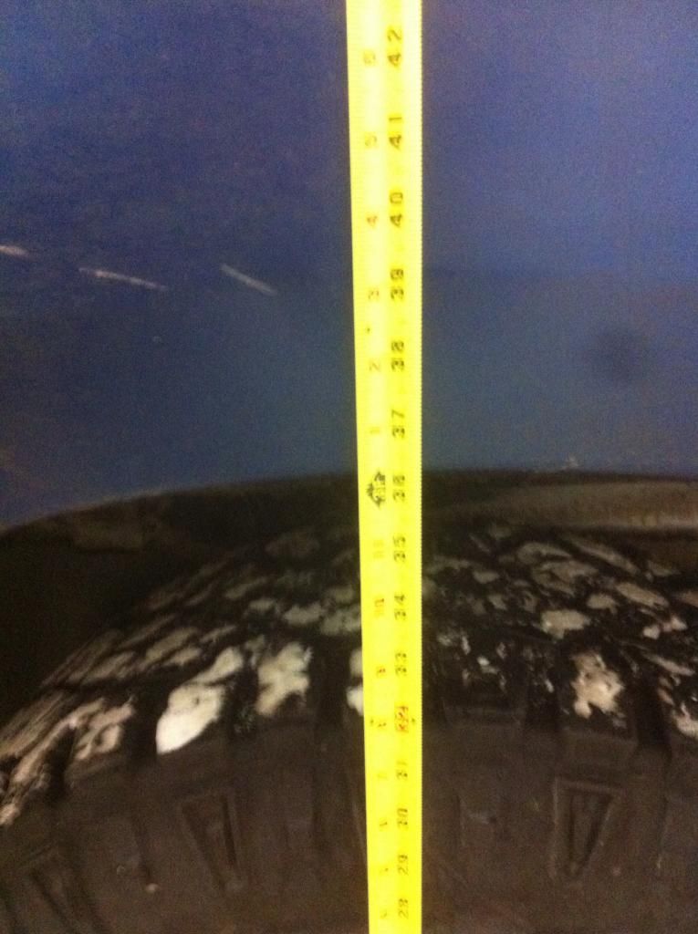

With the truck in the shop, loaded with tools and a 300# electric motor I measured 36" from floor to top of wheel well

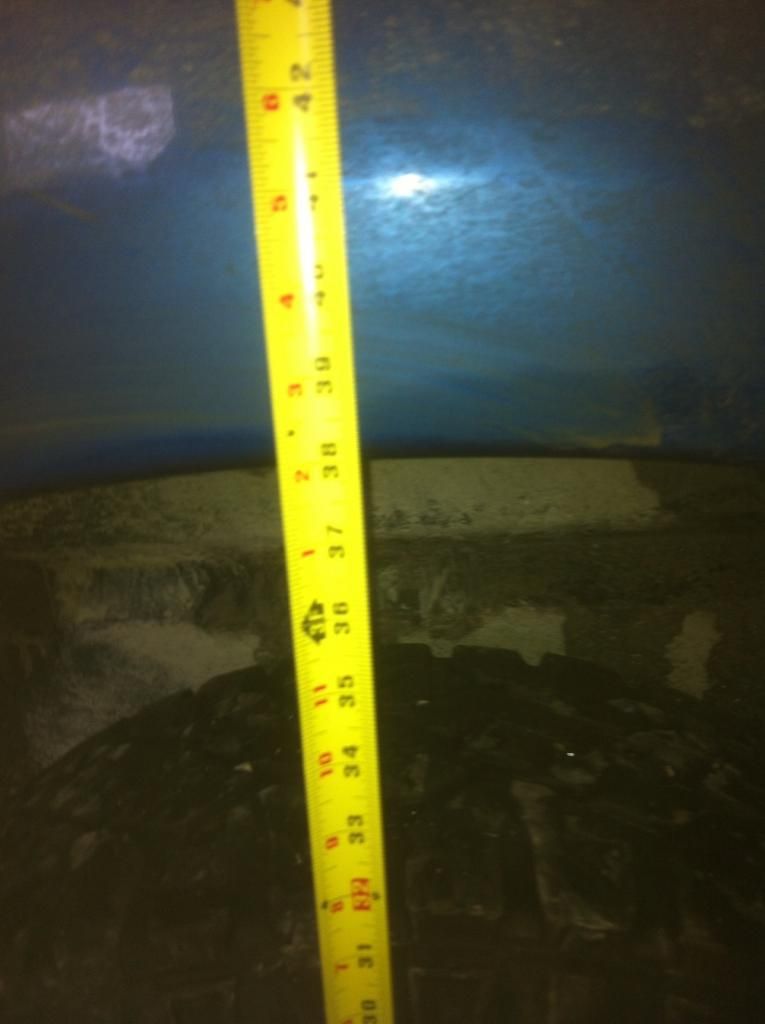

After all was back together height at 38". Sitting level with probably about 400# sitting on or behind the rear axle.
Note: this truck has a 2" levelling kit in the front. When I first installed the levelling kit it sat fairly level unloaded. Now unloaded it sits up about 1" or so higher in the back with the new springs. Still rides nice but can tell it is somewhat firmer. And no more hammering the bump stops
